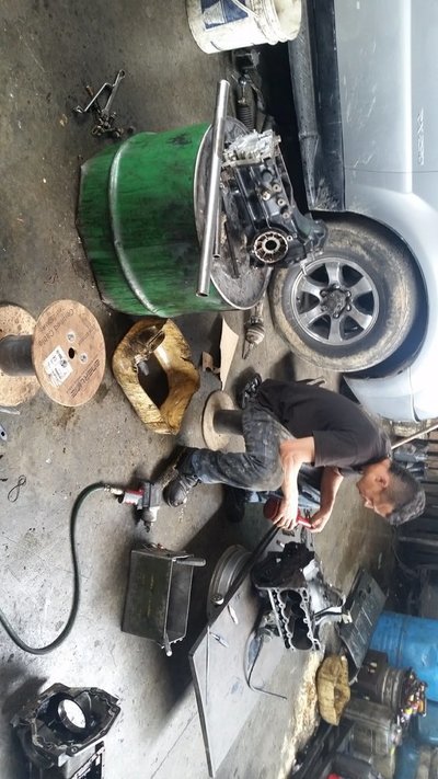

Hello all.. first some background.. I searched extensively on the forums and got some mixed ideas, but nothing similar to my situation so I thought I would reach out. I am here in Colombia and just had the 1300 rebuilt up to a 1400. It would not pass emissions due to smoking, and I was having problems with it staying in 3rd gear and since I found a fairly low mileage tranny and since the motor needed to be pulled to put the tranny in then I figured why not go all in with the engine. The car was running like a top pre rebuild and the mechanics here work in fairly primitive conditions, as you can see from the pics, so I was a bit skeptical but they came recommended and R4's are common here so they knew what they were about. They got the engine back together, seems solid, no wierd sounds, and I passed the emissions, but the engine is seriously lacking power and it is hesitating during acceleration and feels like it is surging or hiccupping at cruise. Feels like it is always going over little bumps in the road. This was not happening pre-rebuild. I used to do a lot of mechanical work back in the day, but here in Colombia in retirement I have just basic hand tools and they work so cheap its just not worth doing it myself.

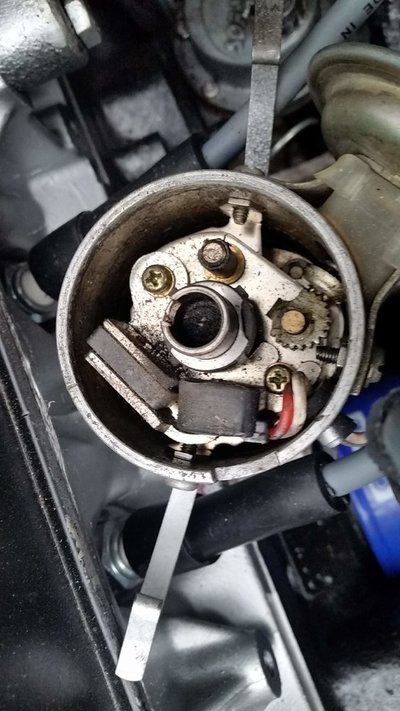

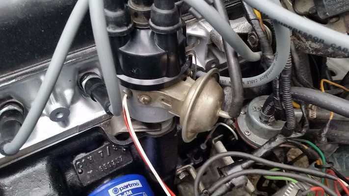

I sucked on the vacuum tube going to the distributor and nothing is moving, this was suggested in a previous post..but why is it a problem all of a sudden and was fine before the rebuild?

I am down to the carb or the vacuum advance as potential problems or the carb as potential problems. Here I cannot buy a rebuild kit for the Solex carb, I must buy all the jets and gaskets as I need piece by piece, its a real pain. As I said I sucked on the vaccum but it does not move one little bit no matter how hard.

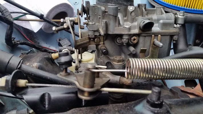

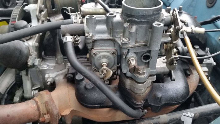

The answer is almost certainly on the second photo: Hose from inlet manifold goes directly to the carburettor float bowl. Remove the carburettor end, plug it and test drive the car to check if it runs better.

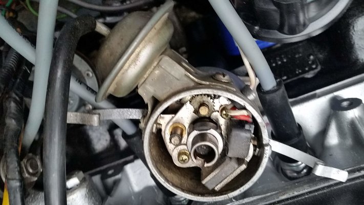

PS double checked that the vaccum advance seems completely inoperative.. not sure if it was disabled for the electronic ignition or not..

These hoses weren't changed during the rebuild.. no attention was paid to the carb just put back together as it was. But I will certainly try. the other side of that rubber fitting attached to the top of the float bowl goes to the top of the rocker box cover.

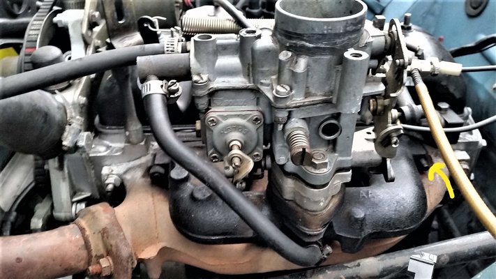

It's difficult to be sure from the photo, but it looks as though the inked manifold nut might be missing (forgive me for copying your photo!):
