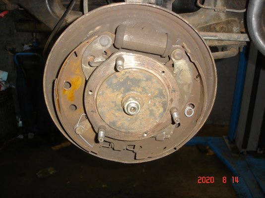

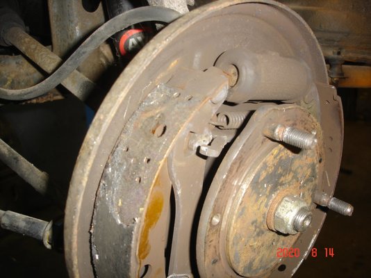

My F4, R2106 850cc, failed it's MOT on handbrake performance. Subsequent investigation showed damage to shoe, a seized cylinder and damage to the internal arm. Pictures attached.
Does anyone have complete assemblies for sale please. New shoes and cylinders being obtained for rebuild.

Sorry - Front axle 228mm diameter drums and Bendix system.

Is this the right cylinder/shoe kit?
https://www.ebay.co.uk/p/1416650891
The PR900 gives 7701202442 as the kit number for R2106 No. 79142>306150, so this might be worth checking.
Can you post more pictures/give dimensions of the internal arm?

Thanks for ebay item. Will search TRW catalogue. Appears correct one.
Vehicle is at the garage which is shut till Monday.
