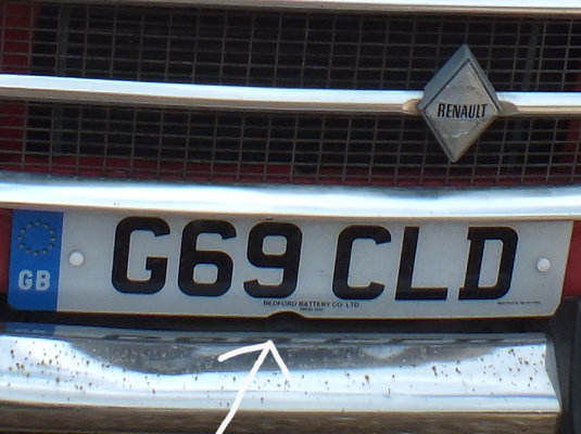

Don't forget to also grind a bit out from the number plate to clear the starting handle bump in the front crossmember. Otherwise the plate cracks when you open the bonnet.
