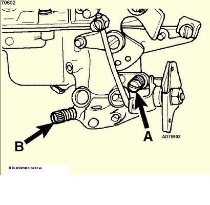

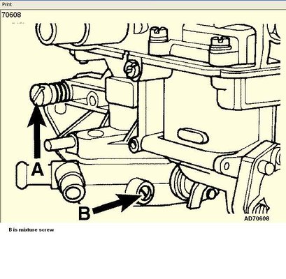

What carb do you have? There must be a mixture screw - it may be hiding under some dirt or hidden under a small plastic bung. If you have the downdraught Solex look under the float bowl somewhere. Is your airfilter clean?
Look hire
It should be one of these, hope I helped.
Sorry for my English.

The carb is a Zenith 32if
Which came from R5 1108 cc 1984 phase 1 car It has no mixture screw I can see Thought I found it but it is just a hole
I have found a original carb that should go on this engine It looks like the second one in the pictures and is a 28if I am going to fit that and am going to get a co2 measureing machine Gunsons do a Gas tester for around 100 pounds To set it up properly for the retest
Any ideas what the co2 limit is in the UK I expect it is similiar in France
If you've got a 32IF from the Mk1 R5 that is very good news. Don't fit the 28IF (it won't fit the manifold anyway) as they are rubbish. I've got a 32IF on my R4 and I can tell you that there is definitely a mixture screw. It's well hidden away and you'll need a very thin screwdriver to adjust it. If there is a hole without a screw it is possible that the screw is missing. The CO2 is anything between .5 to 3% but I always adjust to get the tickover smooth and not lumpy.

I believe the smaller engines did have the 32IF fitted. When they made the GTL they put the 28IF on instead of a decent carb. Why don't you just take the screw out of the other carb and see if it will fit into your 'blank hole'? One of the common causes for the screw coming out is a perished 'o' ring - the screw needs to be held firmly in place for obvious reasons.
Well eventually found the mixture screw under a metal plate that had to be drilled out and with my new Gunsons emission tester got the reading down to .58%
Took the car back for the retest and passed straight away Although the car was running like a bag of **** So when I got home re adjusted the mixture to give around 3.00% The high limit on a 1985 car in France is 4.5% anyway
