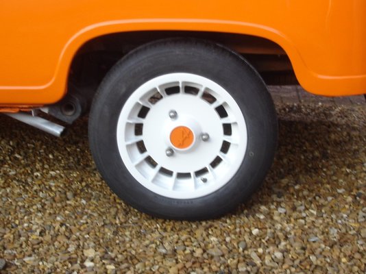

Hi any one know where I can source some Dunlop wheels nuts for the Dunlop alloys as fitted to Renault Gordini. The wheel I am looking is the 2nd one down.

Now that is the crux of the problem they do not have have a taper in the normal manner, they are sleeved nuts that sit in the hole and have a collar that sits round the edge of the hole. Like the image below. I just cant find any in the Renault thread which I believe is 10mm x1.25.
It has been suggested getting some machined up, or machining a taper into the wheels to suit Renault nuts.
Any views?

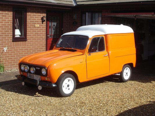

That's a nice looking van.
Does the van have wider rear arches?
I was under the impression that the Gordini wheels in your first pics foul on the inner lip of the arch on a GTL.
I have seen some for sale but avoided them due to this. May have to reconsider.
