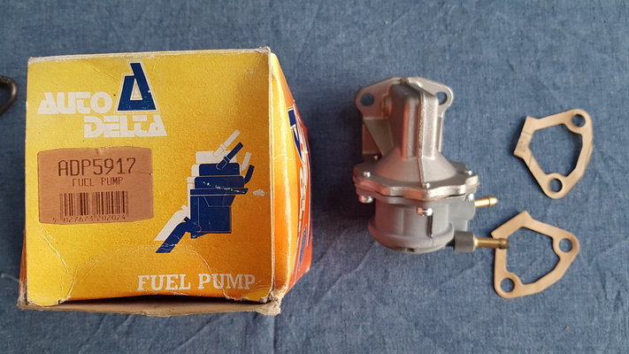

Did you manage to find a fuel pump? If not, I've found a NOS Auto Delta ADP5917 pump. The Renault part number for RHD 688 R4s is given as 7700666046 in the PR900, which cross-references to QFP50.
This is a really useful page:
QFP50,QUINTON HAZELL QFP50; Fuel Pump (yoyopart.com)
Note that quite a lot of 'QFP50' pumps advertised are listed inaccurately. Back in the 80s, you'd quite often be given the wrong pump as catalogues weren't always right!

Is the pump pictures for sale?

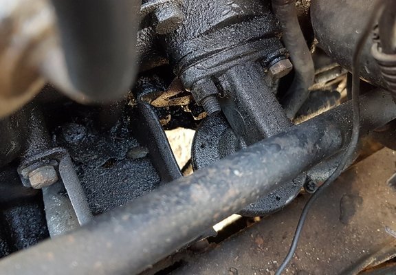

AC Delco 461-91 cross-references to Renault 7700666046 - the part number given in the PR900 for RHD GTLs (688 engine). This is the upside-down, 2-pipe, pushrod-operated pump. Your car is RHD, isn't it?
461-91,ACDelco 461-91; Fuel Pump (yoyopart.com)
The pipes on the AC Delco and Auto-Delta pumps join the pump body at a slightly different angle from that of the Renault pumps - you might have to adapt/replace the flexible fuel pipes. RHD pump (for reference):GTL fuel pump.jpg
