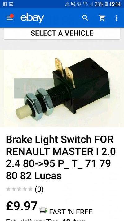

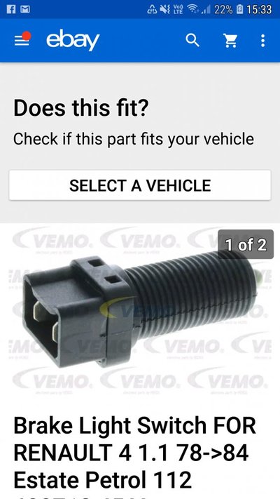

When they Renault 4 was first produced they used a brass thread which usually will undo with your fingers the plastic thread is more resistant and a pain some other Renaults of the. Had the switch in a more friendly location found you one on eBay if you're still looking
https://rover.ebay.com/rover/0/0/0?mpre=https://www.ebay.co.uk/ulk/itm/332214850592
Paul
Thanks for this. Is the brass switch you found a straight swap for the plastic one? Obviously the plug connector would have to go but that's no problem. I have already asked Christian Ebeyer if he has an original, but if not I'll go for the brass one.
Ewan Horne
Some r4 had the push in plastic chunky type
Some where like the plastic threads with lock nuts
Really old 60s and 70s 4 had switch under bonnet hydraulically operated Screenshot_20190810-153353_eBay.jpgScreenshot_20190810-153408_eBay.jpg
