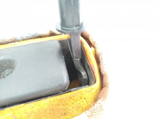

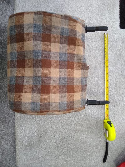

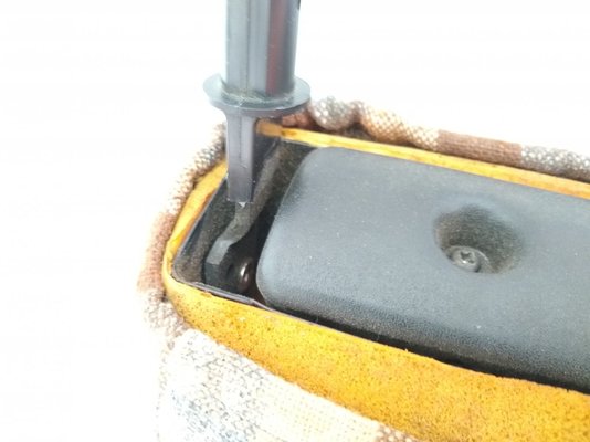

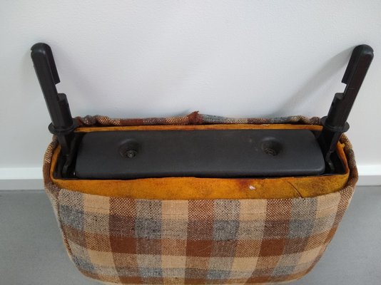

Trouble is, I was expecting the usual chrome/stainless tubular steel supports but instead I have plastic fittings fixed to flat metal (4mm X 15mm approx) legs fixed up inside the base of the restraints.
Neither I or Renault guru Paul Cunningham have seen this type before. Anyone familiar with them? Anyone know how to fit them? If they don't fit my car, does anyone need them?

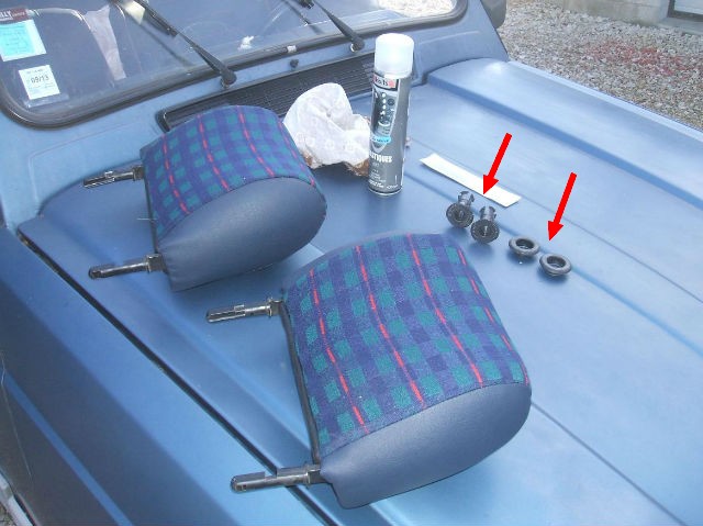

Think those are from the final (post 1989) R4 series when they were named Savane and Clan.

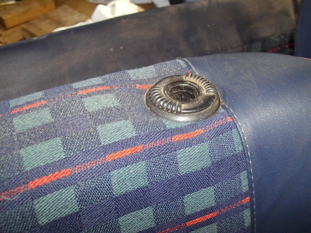

As the front chairs ( from 1978 ) are premade for headrests (240mm) you only need to install the mounting sleeves or adapters (red arrows)

Wow! That's very helpful, enlightening and hopeful - many thanks to you.
I think what you are saying is that yes, the head restraints I have (same fixings as yours) should be compatible with my seats. Good news indeed.
