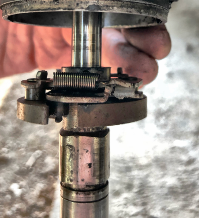

Eureka! Stripped the dizzy & there are 2 springs..someone has been here before me & put in the wrong spring on one side which doesn't hold the parts tight & the other original spring is corroded & does not operate freely at all until the car would be cruising along..accounts for erratic idling & sooty plugs due to having to keep it running with choke out at idle without it cutting out. So...now to get some new springs & I reckon my problems are cured.Screenshot 2019-07-03 at 23.02.17.pngScreenshot 2019-07-03 at 23.02.26.png

thanks Paul, tappets is next on my list, re the carb it's doing the same thing with 2 different carbs so I'm thinking it's not the carb..she sit at idle but the revs lunge to 1000 then back to 750. The long spring doesn't hold the arms tight at all, it flaps about away from the centre by about 6mm..photo doesn't show it.

took my dizzy to a French old Renault chap today..there should def be two identical springs in there, one doesn't work until throttle would be down & one flaps about at idle..they are both pretty done for..new dizzy on its way from ebay fr.

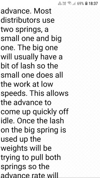

Willing to bet the new distributor you buy will also have to two odd Springs fitted as standard
I'll be very surprised if this cures your problem however without me standing next to the car diagnosis by internet is very tricky
Ha! no not in the slightest! I'm learning daily about these cars so every bit of advice you experienced peeps can give is very gratefully received. It's just what my Monsieur Renault told me, I can't find a diagram for my dizzy anywhere.
I've got no idea where you are in the world as I don't think we've chatted directly before there is several different makes of Sev and ducellier being the most common there is two different sized of the last one I mentioned and definitely not interchangeable between 11 and 8 engines and 8:45 so make sure you're buying the right one to use as a paperweight
