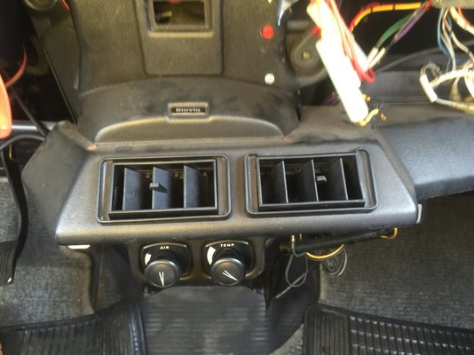

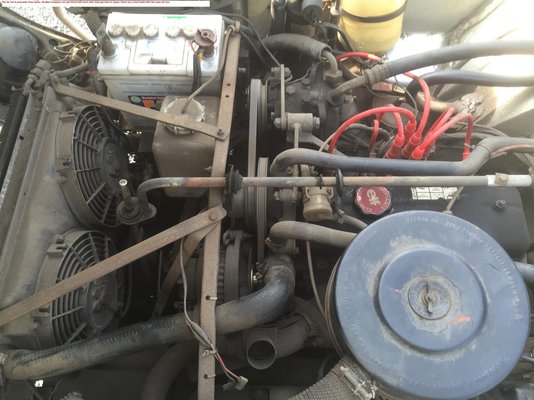

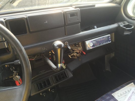

Aftermarket AC in R4 from Japan (put in by local dealer) - pictures are from forum member who went to Japan to live and bought R4 with AC already in - forgot his nickname - sorry

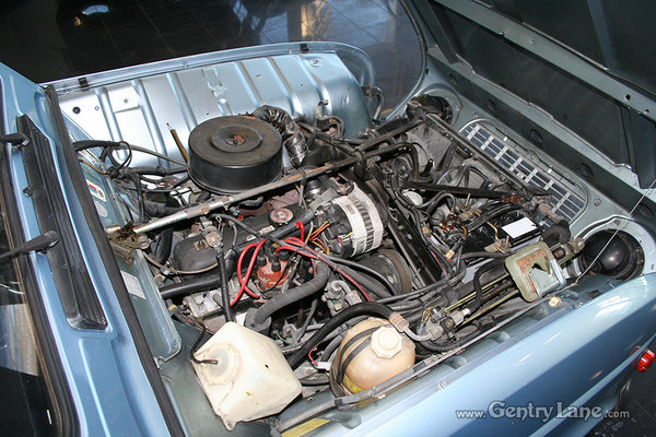

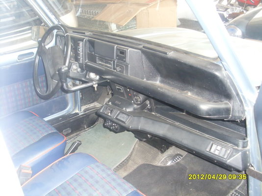

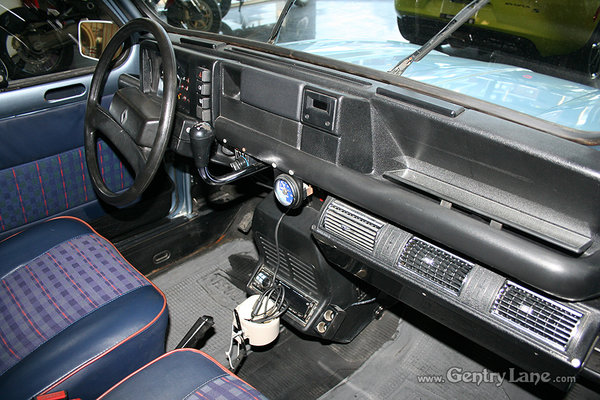

Aftermarket AC (private instalation) - pictures are from Gentry lane dealership http://www.gentrylane.com/s/
A friend of mine bought an R4 some years ago, with a universal A/C fitted. I don't have photos of the installation, the evaporator occupies the space over the passenger's parcel shelf and air is directed by Mini dashboard vents located at the edges of the dashboard (it's the post-83 one).
Petak's engine bay photos show nice solutions for finding a place to fit the compressor and keep the umbrella gearshift lever, on my friend's car it was not possible as the compressor had been mounted in front of the engine over the gearbox (with the pulley facing towards the back) and so they had to use an R5 floor mounted gearshift lever.
