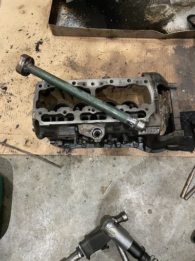

Someone know what thread size inside the bush?
Sorry, I said to "tap the gear out". I meant to say tap the bush out. No idea what size the thread is. Renault used to have a special tool to take out the bush
Thanks mojobaby to led me in the right direction when I see your water tap in the bushing.
Made a special tool from that and it works great
