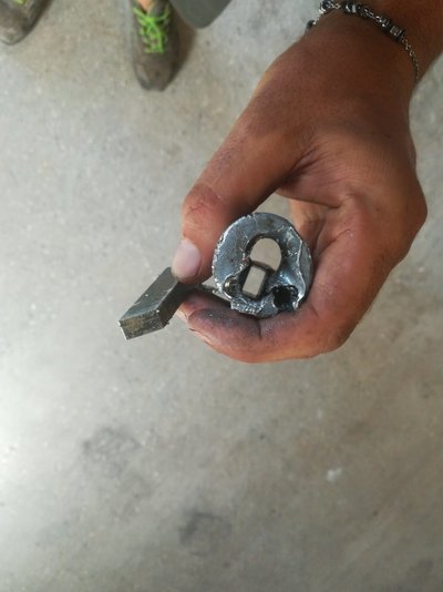

Hello everyone, I've been having a nightmare removing the ignition barrel. I've looked at other threads on this topic but my problem is worse.. So a few weeks ago the key got stuck, I was able to drive it by stalling in to turn the engine off. I have a new one here ready to get fitted. The old key broke is the process of trying to remove it, so I resorted to drilling the ignition. When doing this the steering wheel locked! I have no idea know what to do. I'm loosing my mind from. What I thought would have been a 10 minute job. Any help would be much appreciated

Alan i recall having to do the same on a 1100 Simca fitted with the same ignition steering lock, of course if you have the key or enough to turn in the lock it is a simple job. Still it is out now, well done for your perseverance.
It was a hellish job, four hours for what I thought was a striaght forward job. Setting the timing took me less time :dontknow:
