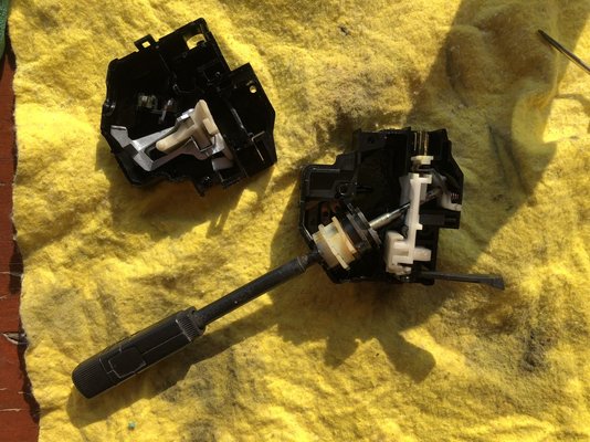

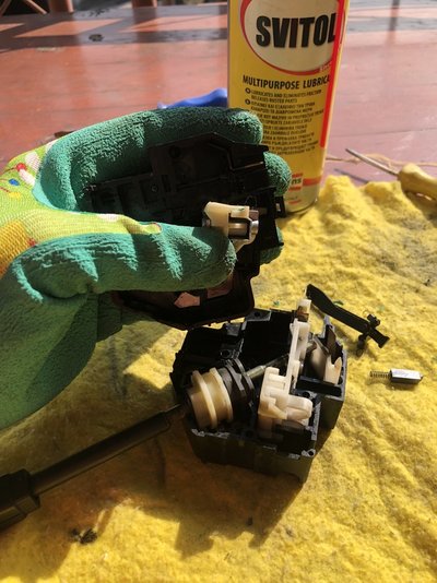

i will disassemble it and try to fix it.. tnx for advice.
switch won't stay clicked into bright lights.. the springs are fine.
I can hold the lever forward and I have brights - but when I release the lever, I go back to 'dims'.
Does anyone have an idea?
Several times I take it apart, clean it, apply grease and lubricant, and it works like new. I hope not only until next year...
