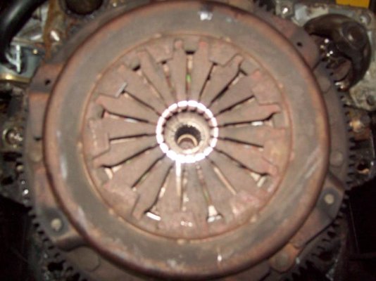

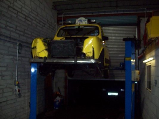

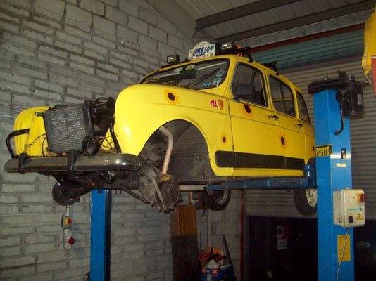

How i love my 2 poster ramp.:smile: Marigold is being treated to a new clutch while Cornish4 is away on holiday. Good job as you need to have strong muscles in you left leg as the clutch pedal is bloody hard and with clutch cables no longer availible (unless someone tells me different) i think it would have been a matter of time before it went ping. The clutch release arm is caked up and stiff so a good degrease should sort it out. Its the first time in many years since i have removed a gearbox on a ramp and cant believe how much easier it is..i have usually just taken the whole lump out for other reasons..
Anyway Brian if you have your ipad with you then heres some pictures:eek:

So it can be done without removing the whole engine?
That's good news as my clutch is probably done within the next season. :(

She looks in pretty good nick under there
Yes she's a pretty sound old car, but I've had to have bits of welding done in the time I've had her for the MOT. Nothing major though, and although she'd had ten owners before me luckily I think she'd been cared for.

Hi folks, I've got Marigold back from renault4mad, he put in a new clutch, which it needed, plus the pedal is a lot lighter now, lots of lube on the cross-shaft. He's also fitted new front suspension upper links and new radiator, as the old, and probably original one sprang a leak. He also investigated the lowered front suspension, and it looks like the car had new floors fitted in the past and the setting for the torsion-bars had been lost, it was two splines out. She's now about 2 1/2 to 3 inches higher then before, and the ride is much better, and she rolls like a goodn'. Next job is new shockers for the back, old ones are past their best, and I'm thinking of raising the back a small amount in preparation for Thenay next year, all that camping gear to carry.
