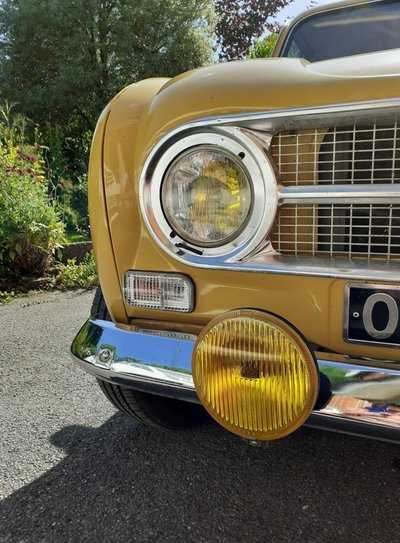

Managed to dig out a pair of clear NOS Cibié indicator lenses today and fitted them with some orange bulbs. I had been occasionally looking for some on the web, but non looked good enough condition or cheap enough + p&p, so discovering these in storage was a pleasant surprise.
They look more subtle against the yellow but more sporty in my opinion , so it's a win win :)...

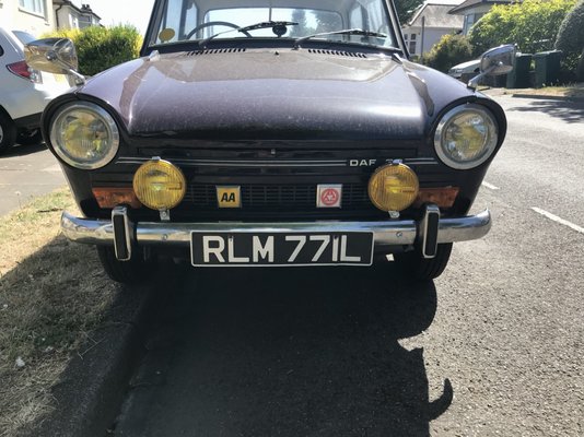

I found a set & fitted them to my Daf 33:

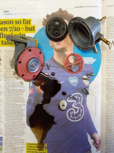

Hi everyone, time for a story about the old chestnut, reproduction part quality :vsad:...
Preface: this is the first time in Dad's many years of 4L experience he has had a mechanical fault on the road.
It begins a while ago, when I had been having issues with starting due to the 4's fuel pump, it would start and then frequently die due to fuel starvation but once the ignition was turned again it would be fine, when previously it would instantly fire into life, whether hot or cold starting. Not to mention on long journeys it would spray a mist of oil out of the relief hole all over the engine bay, which we rustically fixed by wrapping some cloth around the pump...
Fast forward to a couple months back and the car began to need a bit of excessive cranking to start, upon top of the previous problem when it would occasionally die upon starting to need another turn of the key to run. (We were planning on fitting a non return valve to combat this but due to scheduling, hadn't gotten around to it)
Yesterday I took the car out for a spin, I noticed it felt a bit less gutsy than normal and less willing to rev, though I assumed it was due to filling up with 95 rather than 98 octane fuel the previous day...
Which brings us to today when I drove Dad into London to pick up a customer's vehicle which he would drive back home and I would follow behind in my car. First sign of trouble was when leaving the garage and starting my car, the revs fell to about 400 and the engine died, though when restarted with the revs held, all was good (assumed fuel vaporisation at the time due to the very hot weather).
Long story short after sitting, bloody melting, in a 36°C+ traffic jam :flame:, whilst trying to avoid another traffic jam :dontknow:, the car stalled when I was pulling away and then just down the road the idling revs fell again and the engine conked out and wouldn't restart. Naturally this happened on double yellow lines in a congested street, but we managed to push my 4 to a very close by carpark. After first checking the electronic ignition Dad determined the fuel pump had packed up.
Thankfully we had the customers car to get us home, so we payed for a ticket for the R4 and drove home, cooled down for a while and then went back to my car. We rigged up an electronic fuel pump to get the car home, the car for sure felt more gutsy than before which leads to the conclusion that the pump had been effectively leaning off the mixture over time. I also suspect there's a high chance that the diaphragm was at fault and was damaged by the ethanol in modern fuels, leading to the problem, though OEM pumps seem to be more hardy...

Fuel pump replaced with cleaned and checked used original spare, and all is now well :).
We took the old pump apart and found that the oil seal on the diaphragm shaft had failed and oil had filled the chamber effectively hydrolocking the pump, hence the oil slick in the picture below. Originally we suspected the diaphragm may have perished due to ethanol though this was not the case.
Unfortunately the rest of the pumps components are in perfect condition but is unusable.
