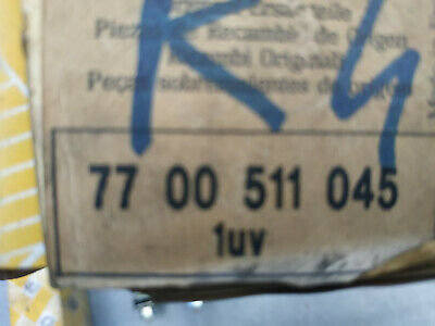

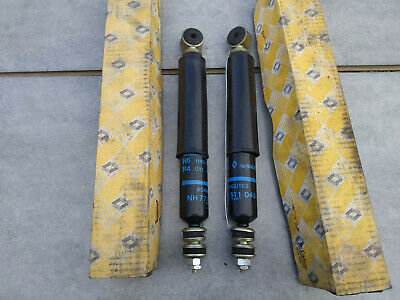

Does anybody knows do these fit my 1990 GTL? Are they gas pressured? Is it better to buy these NOS or new absorbers? Do absorbers and rubber parts on absorbers lose performance over the years?
View attachment 24276 View attachment 24277
Definitly gas as they have retaining wire clip needed to successfully fit to rear without struggling
In theory all R4 rear shocks fit all models regardlessof model type
