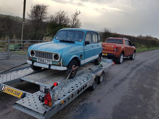

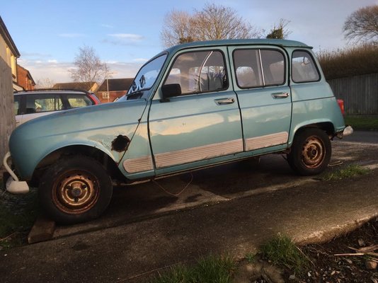

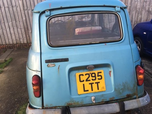

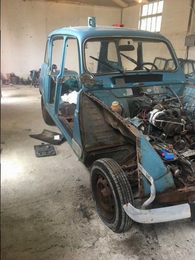

Right then....I have already posted a “hello” thread so instead of spamming that post in the wrong place I thought I would start one in the right place!
This is Claude, a 1986 french r4. 845cc.
He is going to be getting a full restoration (eventually) and I’ll be learning a lot of things along the way. I’m a fairly capable mechanic but my welding experience isn’t quite up to scratch so that’ll be something I’ll have to lean....thank god for forums and YouTube!
Any way I’ll post some pics...

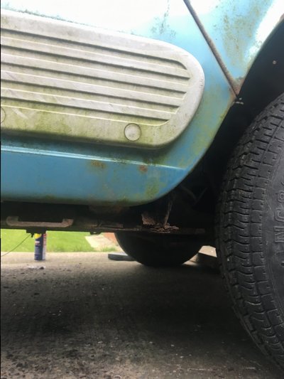

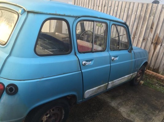

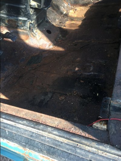

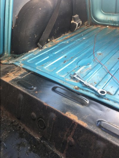

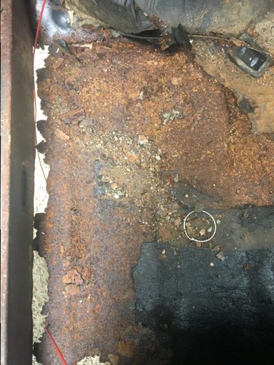

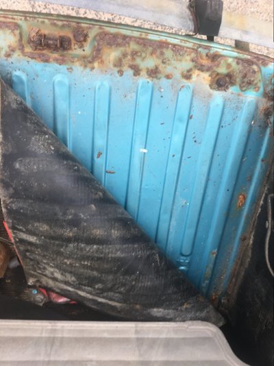

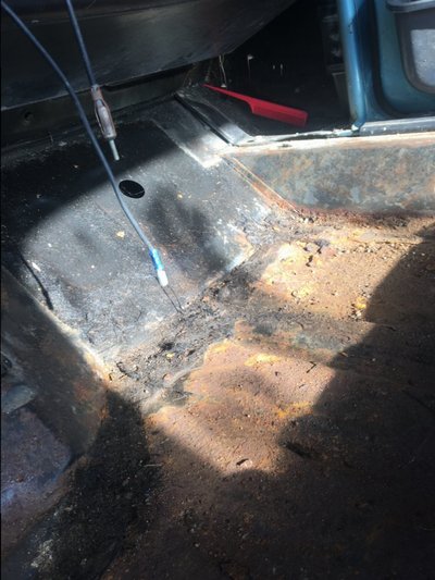

That was on the day of his arrival, I have since had a few minutes to have a dig around. The front floor is 70% shot so I’ll just replace the whole thing, rear has a small patch that will need a repair on the drivers side.
Boot looks great apart from some surface rust.

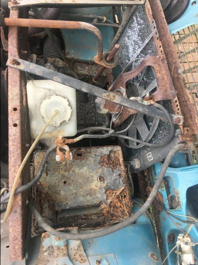

The chassis is in ok condition, most of the rust appears to be on the drivers side with the exception of a hole on the bottom of the front wing on the passenger side.

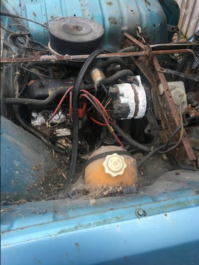

Engine wise...all seems to move freely just a little dirty! And I think there may be gearbox issues as the gearstick pulls out a hell of a lot!
Plans are....firstly strip out the interior and engine so they can go in the shed and get some love in the evening when I have most of my free time then as the spring/summer roll around the body will be separated from the frame and I can concentrate on getting it structurally sound before I attempt to prep and repaint the body!

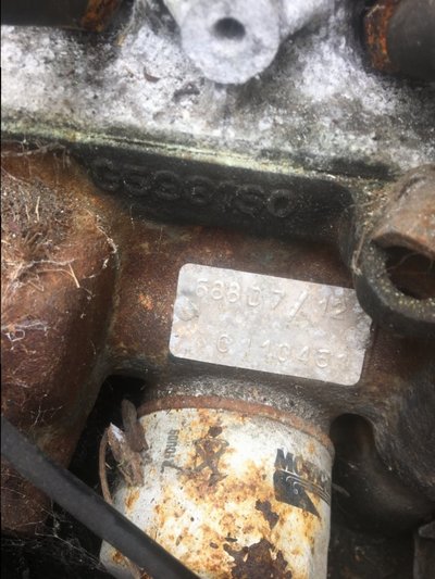

By the way, your engine looks like an 1108 GTL to me - if it has '688' (or, less likely, C1E) on the engine plate, it'll be an 1108.
Best of luck with the restoration!
38
Pembrokeshire
#7
Thanks everyone, Andy...I already have the pages saved on my phone haha! Although I may need the help of my teenage son to translate some of them
That’s interesting re: the engine, I will have to have a closer look at that as the logbook states 845cc...it would be nicer to have the slightly bigger cc engine!

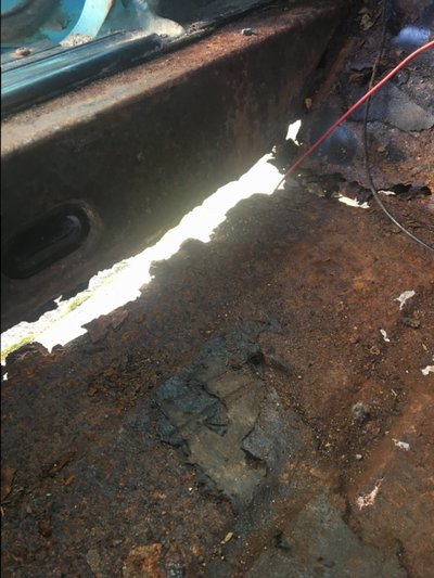

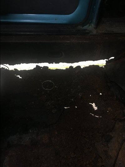

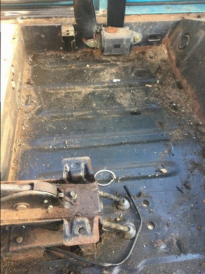

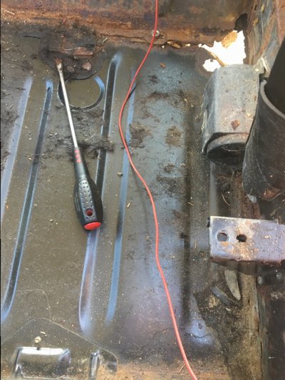

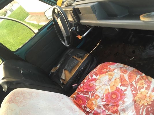

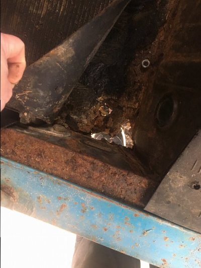

Had a spare hour today so I decided to get the interior out and have a closer look at what I’m dealing with, a bit more work than I was hoping for but not as much I expected! Rear floor seems to have been replaced at some point as there is an odd looking nut and bolt holding them in near the heel board? Not sure if it was built like this or something someone has done to hold the floor in place before welding.
Frame is fairly rotten but nothing that a little graft won’t sort...just out of curiosity does anyone know what gauge steel the chassis is made from as I can get some ordered ready to go.

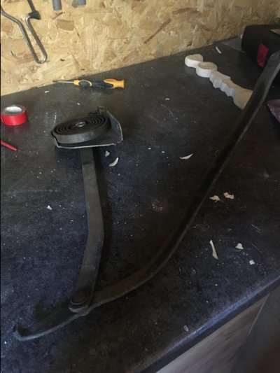

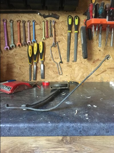

Oh and my boot support is a little....warped?! So that’s in the shed awaiting its date with the vice and a hammer.

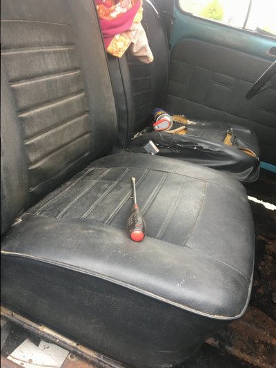

So the plan for the next week is to hopefully strip the drivers seat down and dust off the old sewing machine and see if I can’t make a new seat cover as the passenger seat and rear bench are in pretty good nick!

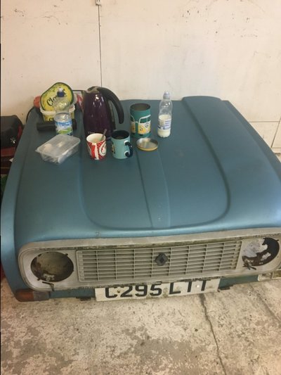

Afternoon! Bit of a busy month here so not a lot done on Claude...I pulled the front wing in the hope that I could fix the massive hole in it but as soon as the grinder touched it I was greeted with a huge cloud of filler dust ‍♂️ So that’s toast....it’s going on the list of parts o need to order/find.

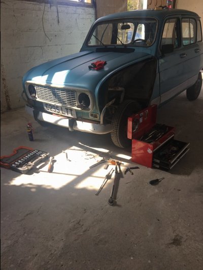

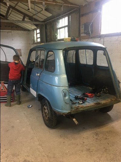

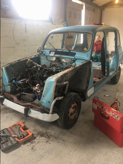

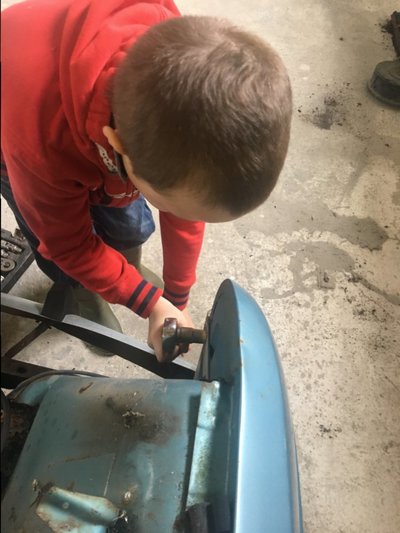

Well I had a few hours spare this morning so went on up to start stripping Claude, managed to take one of my mini helpers to lend a hand, we managed to get almost all of the body panels off. I have started to remove the wiring and surprisingly only 2 bolts have sheared so far! (Bumper bolts)
It’s a fair old slog making sure everything has been organised and labelled properly but it’s nice to get the kids out doing something that isn’t playing Xbox!
Next jobs will be drain the tank, remove the rear fenders, finish the wiring and hopefully pull the engine....I’m hoping to have the body removed from the frame over the Easter weekend
Thanks, Dave
