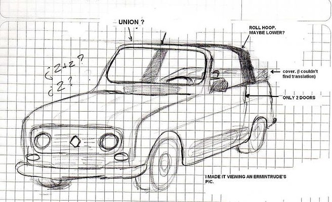

Drawing
It's me again !! Like i've said, i'll post a draw about my new ideas. Dont laugh, please. I made it * 2 a.m., after 26 hours without sleep :smile:
Like I wrote in the draw, I made it with an ermintrude's pic in my screen. I reflected it, like in a mirror.

I think it would called a convertible here, though cabrio works too.
I saw a photograph of a car that looks very like your drawing, but I can't find it any more. You would need to buy a welder to do the modifications. MIG welding is easy to learn and fairly cheap.
You might get some ideas from the Plein Air. The doors were cut away on that car, but you might be able to find enough information on the internet to copy the roof.
One other thought - the windscreen supports wouldn't be stiff enough to support the car if it rolled onto it's roof. I don't think the Plein air had extra support (people didn't seem to worry as much in those days) but a T-bar (support from the rool hoop to the centre of the windscreen frame) might add strength.

Well, Clementine, you're a very claver cat, and i can't follow your speed. I couldn't find the photo you said! I've already see that Plein Air. I've one of the last pictures as an Msn avatar =D. And i don't want to cut the doors that way, but i'll look it much closer, and see what is useful to me. Specially the T-Bar idea, you're right, if the car rolls upside down, the roll hoop will be scrap. I just spect that it dont ever happent !!!

The Plein Air cars were built as normal saloon cars and converted by a company called Sinpar (the same company that made 4 wheel drive Renault 4s). There are fairly detailed plans for the Plein air body in the early 1970s workshop manuals.
I don't like the cut away sides in the Plein air either - I think that car would be uncomfortable in side winds.
For rolling over - I don't think the saloon Renault 4 roof would be very strong either.

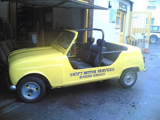

Sinpar also did a very nice 4 door convertible, like your avatar. The Renault 4 Book "La Renault 4 de Mon Pere" has a motor show photo of one.
Heres one we made earlier !
Built this about 10 years ago
