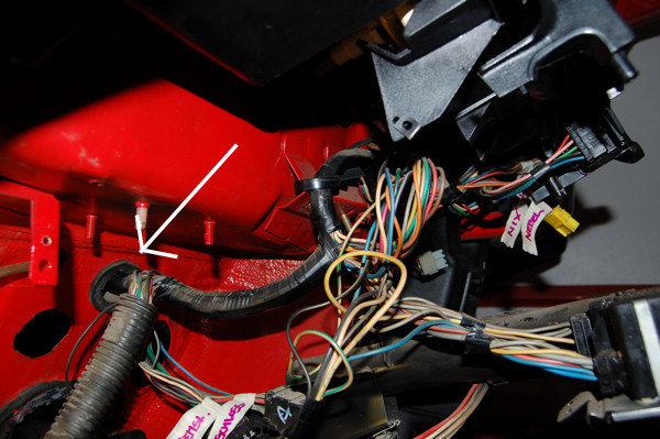

and I've got a problem - how I can take the electric instalation from engine and front lights into cabin - I think the hole is too small for this :confused:
Maciek,
you can feed all the cables from around the engine through the opening into the "cabin" (I suppose you mean the inside of the car) and remove it as one unit. There are a lot of connections/connectors in the engine compartment that can be separated so you don't have to feed every little cable and connector. But don't forget to mark them before disconnecting!
