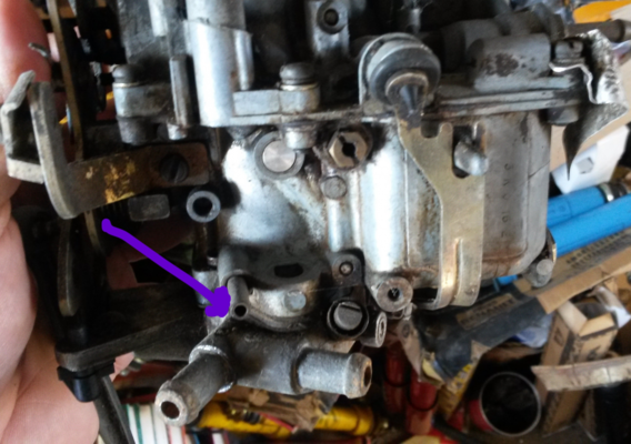

J jasongtl Enthusiast Messages 13 Location france Apr 21, 2019 #1 Hello, I've fitted a 32 solex R5 Carb and Mani on my 1128 gtl, the carb doesn't seem to have vacuum for the dizzy, anyone done this mod can give me some tips? Cheers

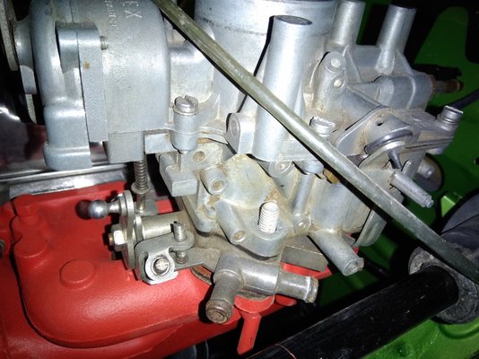

Andy McGhee Enthusiast Messages 1,538 Location Cheltenham Apr 21, 2019 #2 Hi Jason Is this the same carb? (Solex 32SEIA)
J jasongtl Enthusiast Messages 13 Location france Apr 21, 2019 #3 looks like the the nipple's been removed. Cheers
