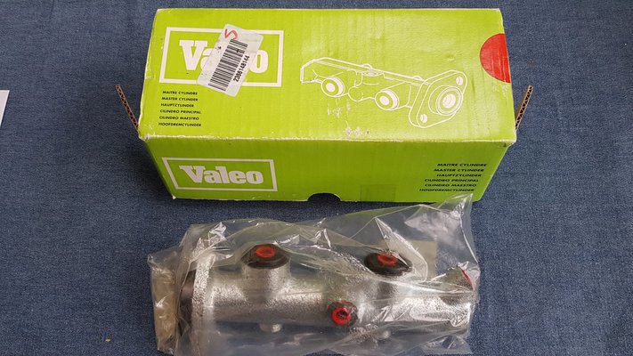

The master cylinder is a Valeo 350454, equivalent to Renault 7701348206. It's still bagged and boxed:

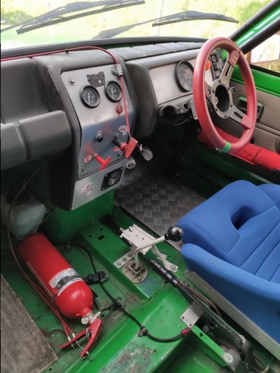

Hi Everyone,

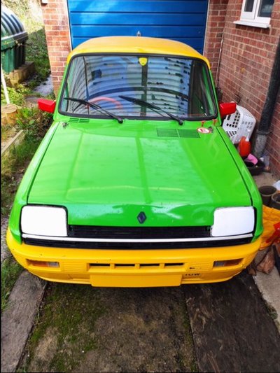

Thanks for your replies. I will attach some pics tomorrow. Been rushing around last couple of days and it’s dark now! Tried to take some photos, but...

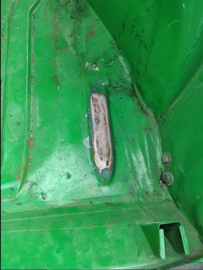

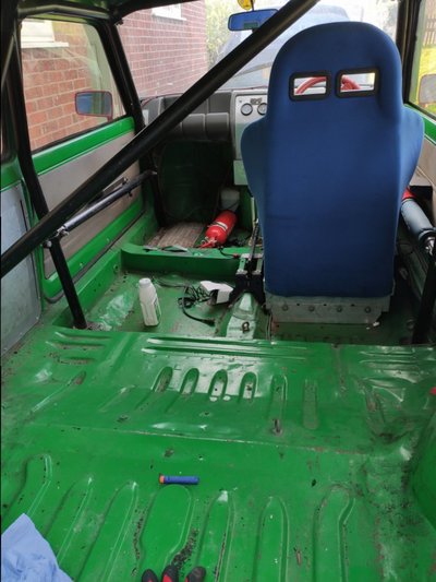

I have been searching for the chassis number imprint. Nothing in the boot floor, and none visible under the bonnet, so I may have to remove the race seat. It’s probably going to be replaced anyway. That harnesses are well-expired, but in decent condition. I may pop both in the passenger side for track days and instruction etc.

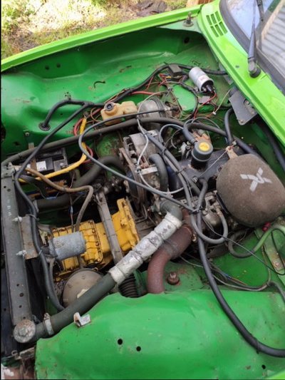

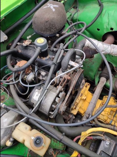

looks almost like a normal format R4 engine and gearbox but Im puzzled how the gear linkage works? What size engine capacity?

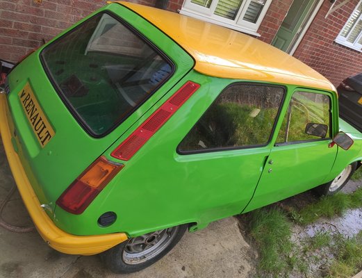

Very green!
Not looked at the gearbox linkage, but was wondering that myself...
I think the engine is 1400, but will need to find the number to see.
Does it have Bilstein dampers and thicker torsion / anti roll bars?
