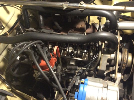

Didnt get round to doing work as anticipated until a late start this afternoon, removed rocker cover to see this:-E2435D42-6235-46CE-80A1-25A4BB193A81.jpeg
As anticipated, the head looks very new (result TBH), checking torque of headbolts just gave me 10 clicks and no movement, found that quite reassuring, also checked the tightness of the rocker assembley bolts in relation to head before getting ready to adj. tappets.

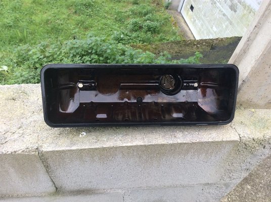

The inside of the rocker cover again looks in good order, will give a thorough clean before refitting, heres a pic of it as it came off, the clean ‘streaks’ where there when removed, again an indication that its been worked on pretty recently.

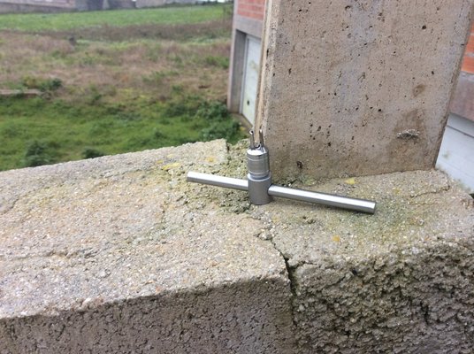

Then got busy with a grinder and turned a 4 mm soket into a dedicated for 4 4 mm adjustment tool, should of got round to this before but doesn’t time just seem to fly when your tinkering with these cars?
