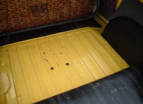

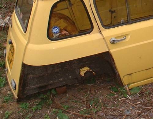

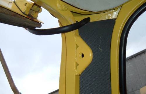

I've attached a few photos of the GTL rear seatbelt mountings. The mountings in the floor are the two black dots in the middle of the photo. Those and the mountings in the wheelarch (represented in the photo by a large rusty hole) take the form of a 3mm plate behind the body panel with a big nut (17mm spanner, can't remember the thread size - is it 10mm?) welded to the reinforcement. The reinforcement plate in the floor is about 250mm*150mm and the one in the wheelarch is maybe 150mm*150mm. Figures are from memory.
I can't see any reason why a competent welder couldn't fit the mountings safely. The GTL rear belt is a plain (not inertia reel) type. Must be possible to buy universal ones. Inertia reel belts would be possible but you'd need to add a further reinforcement to the rear of the wheelarch to mount the inertia reel.

Clementine, you are a star. That's just the sort of info I need. I have discovered that Securon make an innertia reel rear belt for the 4, which is the type that can be mounted at any angle, so I assume that it must be fixed to that upper mounting point.

I'd be inclined to mount the inertia reel bit in the handy space on top of the rear wheelarch and then fit the loop that comes with the seatbelts to the rear mounting point. You'll need to devise some sort of mounting for the inertia reel bit. If you go overkill with a big steel plate that would pull the entire wheelarch out of the car before it moved then I'd think you would probably be OK.
I'm sure Liam (liam4r4spares) will be able to cut the rear mounting out of his next scrap car - might be worth sending him a private message (pm) or checking through his posts to find his contact details.
