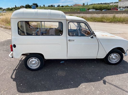

Pictures to get better idea what kind of window i am talking about (picture taken form leboncoin add)

The photo appears to me to have a central divider/vertical strip.
Is this correct? They appear to be sliding because of a little overlap.

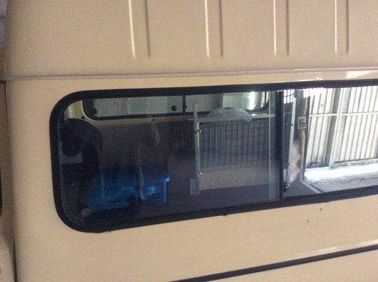

Think just looking visually the F6 are longer, do know both my windows slide if the central latch is released, has tab knobs each end of glass, do notice the F4 windows look like the front glass slides rearwards, cant see knob /handle visually to slide rear glass forwards, F6 rubber I suppose could be cut down to fit F4 aperture as the corner profileslook very similar, the rubber itself from when I removed rear window to tint does look as if original just comes in lengths formed when originally fitted as does the height in relation to door glass look the same either F4/6.A1E0A60B-7DB4-46CE-ABBC-73AEB8949C49.jpegF94EFA94-C2F4-40F6-89E1-EB2C036C7FE4.jpeg

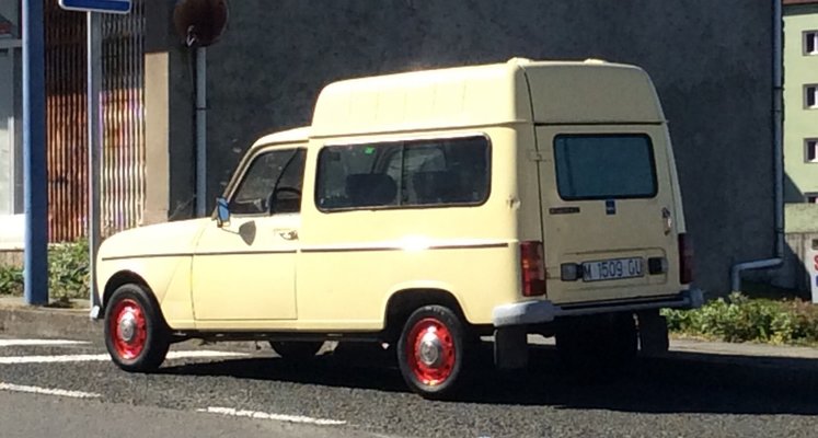

To me it looks like F6 windows are little bit longer and have smaller radius at corners than F4. All of this i am claming according to pictures from net/web. But in many cases pictures may leed you to wrong conclusion. That is why i was wondering if somebody here maybe know that information.

Since the F6 is 20cm longer than the F4, side windows should be longer by the same amount.

The glass is wrapped up, but the opening measures
Width 1010mm
Height 348mm
Hopefully this helps you out.
