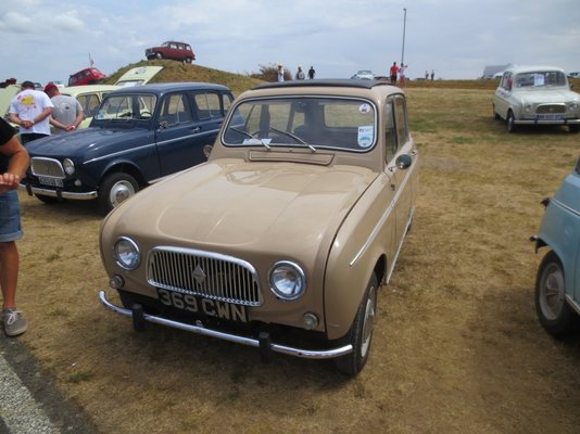

I'm very proud to be the new owner of the Renault 4 super, now christened as Henri, as rescued by the Gresham Flyer. Lovely bloke is Mark and you can see he made a cracking job of the brakes.
I have decided that as Henri is so good, he should be treated to a gentle re-spray after I get him to next base with a new MOT and English registration.
My jobs so far have been to strip the starter and after a really good clean-up, he starts on the switch (no ignition key here).
I also removed the dash and wiper rack and motor as the spindles were seized solid. After gentle heat, the spindles tapped out easily and following a thorough de-rusting and good greasing, the rack has gone back together and 'hey presto,' we have working wipers.
I have ordered a Haynes manual, so will puzzle through what it needs to make the indicators work. The silencer was shot, but I'm collecting a new exhaust system in Leeds tomorrow.
I do need wiper blades and also to sort the headlamps (yellow 6-volt bulbs not friendly to mot testers) and a new set of tyres. I will keep updating progress to getting the MOT.
Does anybody know where I can get wiper blades, windscreen and door window rubbers from?
By the way, Henri now lives in Scarborough.

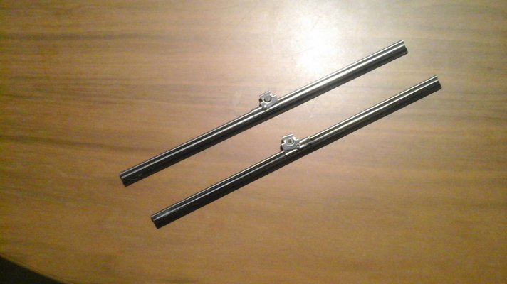

Found these wiper blades for you if you still need them...View attachment 17244
Sorry for my tardiness Stuart. I would love the wipers. They are the correct part for Henry. How much do you want for them?

How does a tenner, inc post sound?
Message me your address.
Cheers...
First class Stuart. My address is 176 Scalby Road, Scarborough, YO12 6TB
Ian Froggett the name
If you want to email me ian_froggo@yahoo.co.uk and let me have your full name, sort code and account number, I'll transfer the cash, or if you want payment any other way, let me know.
