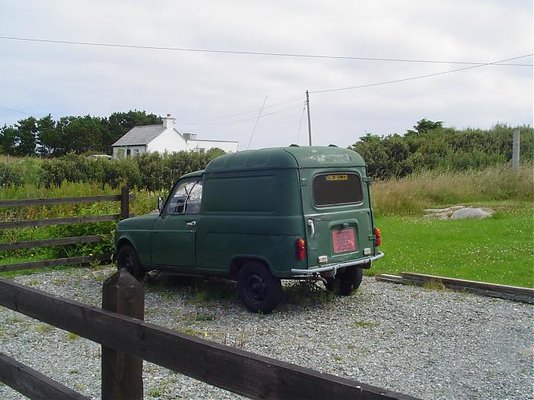

AFAIK, the tail lights on the F4 vans were never fitted with reversing lights or fog lights. The attached pic shows the reversing light arrangement on an Irish F4 van that a mate posted to me. The fog lights always seem to be seperate, usually mounted below the bumper.
