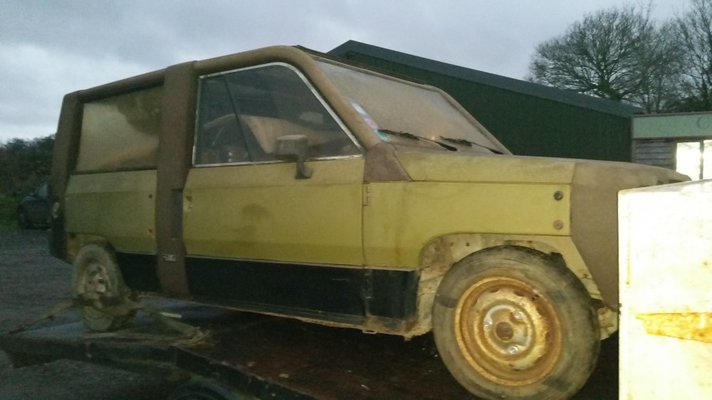

My reward for helping has been to become the proud ? owner of these 2 which have been standing at least 20 years
Based on 1980 gtl 4 chassis and mechanics hopefully I can get one back to a working vehicle

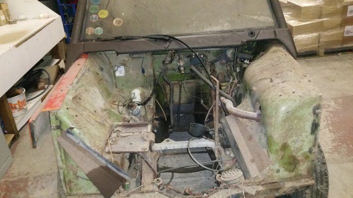

20150218_162516.jpg 20150218_162533.jpg 20150218_162555.jpg 20150218_162533.jpg 20150218_162516.jpg

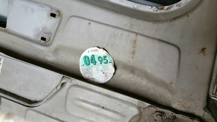

managed to get the green one to run after changing the starter motor and pouring some duck oil down carb as acess to plugs is not as good as normal 1108 4
still a bit slow so decided 24v might work it fired up and ran perfectly once I readjusted points from 37 degree dwell angle believed to have stood since at least 2000 with ct sticker ending in 96
the pictures are of the orangey red shell being dismantled today there have been some interesting bodge repairs done more pics to follow

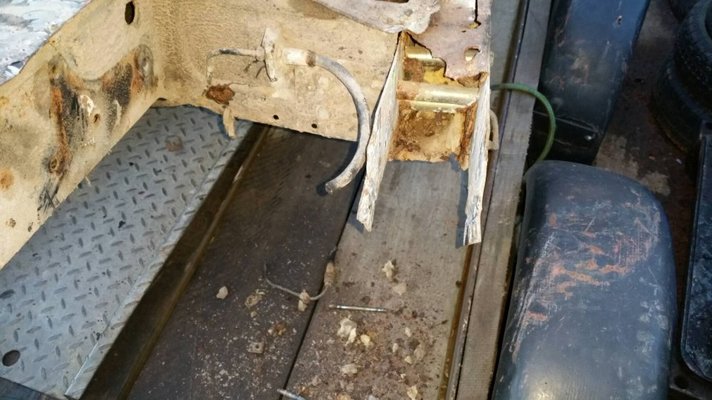

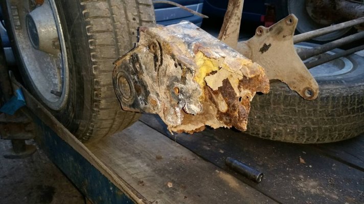

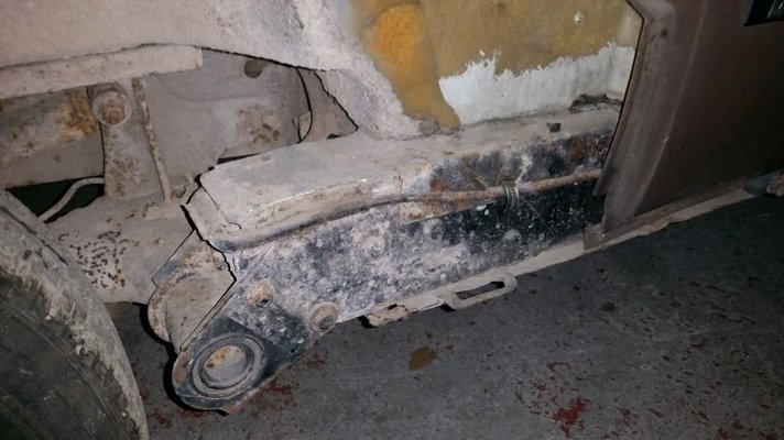

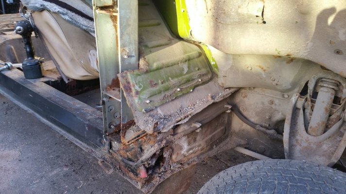

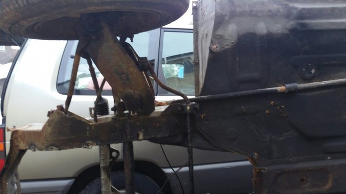

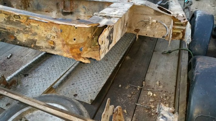

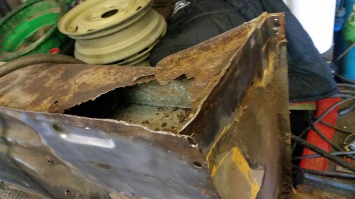

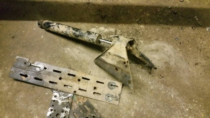

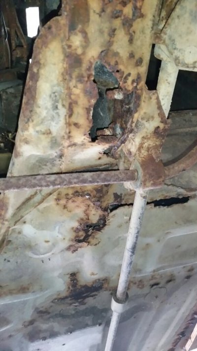

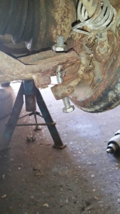

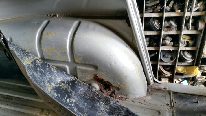

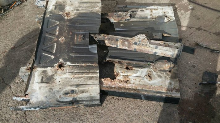

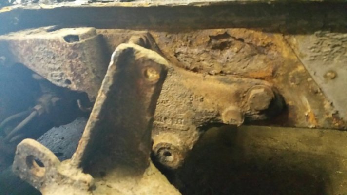

20150223_182757_resize_20150228_095208.jpg 20150224_172212_resize_20150228_095206.jpg 20150223_182845_resize_20150228_095207.jpg 20150224_172249_resize_20150228_095204.jpg 20150224_172231_resize_20150228_095205.jpg 20150225_145735_resize_20150228_095203.jpg 20150225_153041_resize_20150228_095201.jpg Forgot to keep you updated with more pics been continuing dismantling the shell further

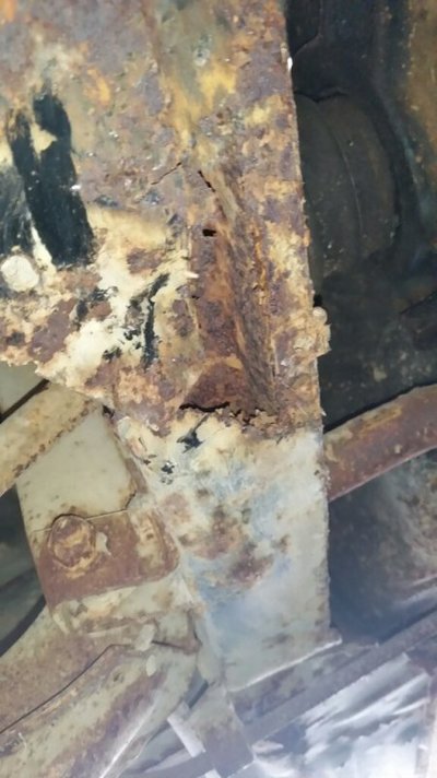

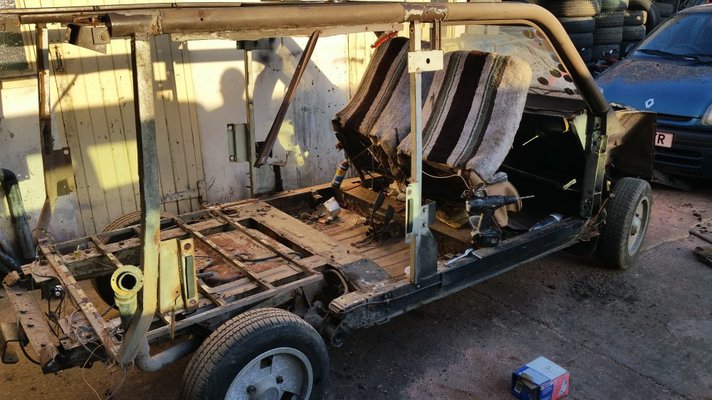

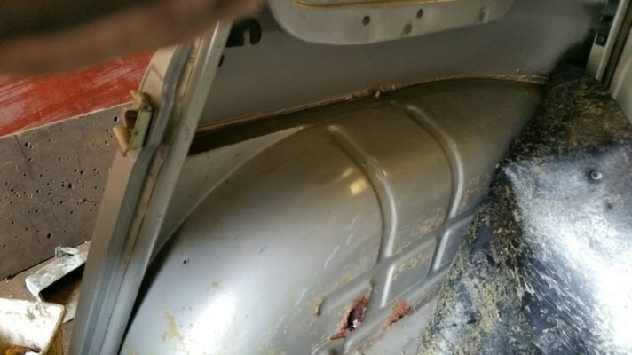

Once the bulkhead was unbolted I decided to unbolt rear suspension complete after loading on trailer to save having to load bare chassis I used my engine crane to raise the rear end so the axle would drop out easily I started to undo bolts when rear chassis broke next to the bodged shocker mount
Obviously I was keeping clear but still surprised me . The bodge on rear arm mounting was also quite interesting as there was not a single welded repair on whole car only ally plates pop rivets maybe they were worried of setting plastic on fire

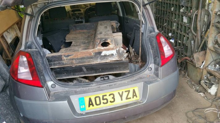

Final development was when I rang Andrew Lewis asking if he wanted any parts mentioned the front chassis perfect so ended up cutting it all up and loading the rusty bits in a scrap megane
Ps there was a lot of sweeping upto do as well

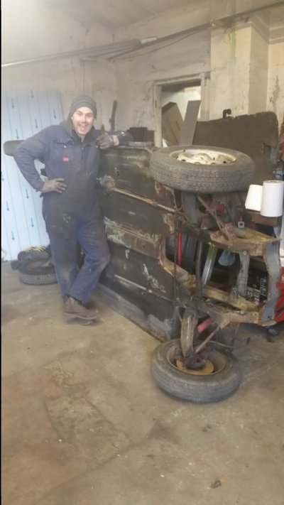

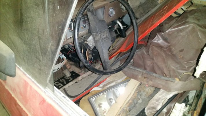

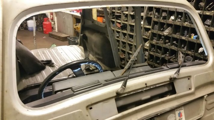

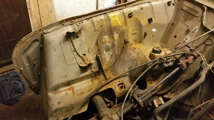

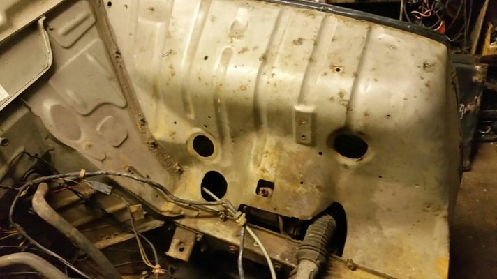

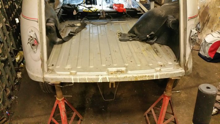

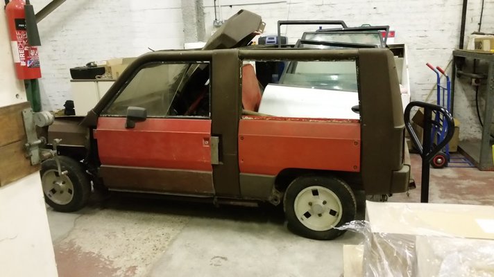

20150311_121243_resize_20150313_103110.jpg 20150311_121413_resize_20150313_103109.jpg 20150311_121401_resize_20150313_103109.jpg 20150312_182602_resize_20150313_103107.jpg 20150312_182535_resize_20150313_103108.jpg 20150312_182615_resize_20150313_103107.jpg 20150312_182829_resize_20150313_103106.jpg 20150312_182641_resize_20150313_103106.jpg 20150312_182842_resize_20150313_103105.jpg 20150312_182859_resize_20150313_103104.jpg i don't seem to have mentioned that i have got a renault 4 gtl i am stripping down this has been standing since 95 with a head gasket body and chassis seems good but seems to have been vandalised before i got it hence being used as a donor vehicle pictures of me attempting to remove the body shell which is heading to norfolk tomorrow
on this car the chassis seems quite solid and will need minimal welding once the body is off i will post more pics fingers crossed as i can't weld and it's got to go somewhere else for welding

I just love this photo.... I can see the eBay advert now... RENAULT 4 in need of sympathetic restoration... Remainder rusted away... Well you will get loads of encouragement from me

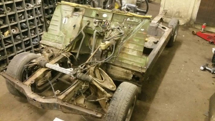

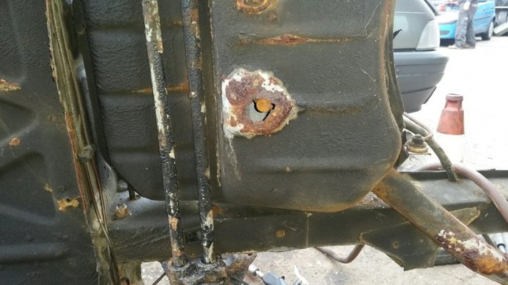

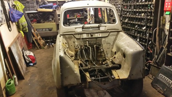

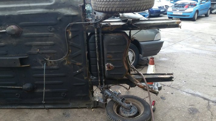

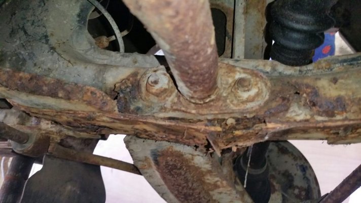

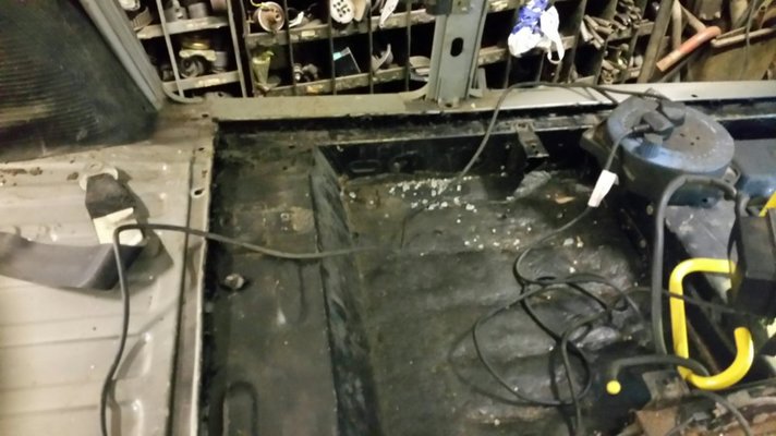

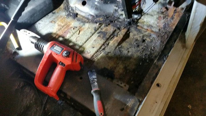

20150314_133802_resize_20150318_224340.jpg 20150314_133740_resize_20150318_224340.jpg 20150314_133826_resize_20150318_224339.jpg 20150316_161455_resize_20150318_224337.jpg 20150316_161515_resize_20150318_224336.jpg 20150316_161421_resize_20150318_224339.jpg 20150316_161437_resize_20150318_224338.jpg Bit more space now jonathan t has taken the body away so room for a quick look underneath and hope for the best
Definitely no fuel left in the tank but nothing too drastic
These pics from Monday had the rotary wire brush on it today but forgot to take pics
Being welded friday more to follow

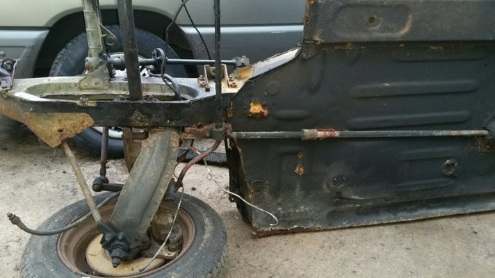

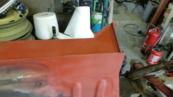

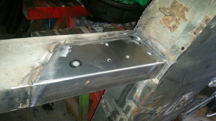

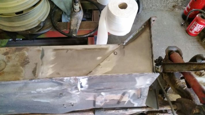

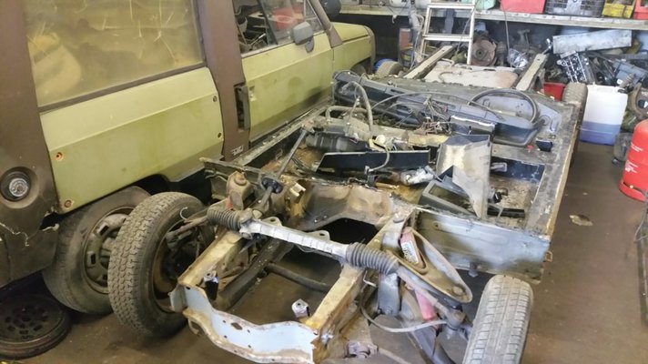

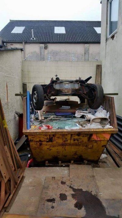

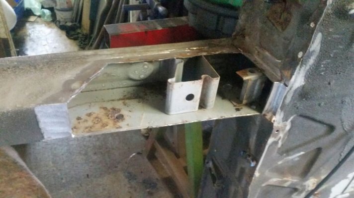

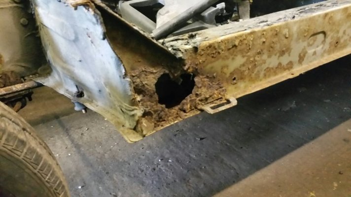

FB_IMG_1427355307325.jpg 20150324_124838.jpg IMG-20150324-WA0011.jpg IMG-20150324-WA0010.jpg IMG-20150325-WA0011.jpg IMG-20150325-WA0014.jpg IMG-20150326-WA0005.jpg jonathan and everybody else following this here's your latest update car was delivered to my friend Chris tullett who is a welding fabricator local to me and seems up for the challenge
space issues when i dropped it off meant it had to be parked temporarily in a skip a few days later he was busy getting on with it these are a few pics as this Side now complete

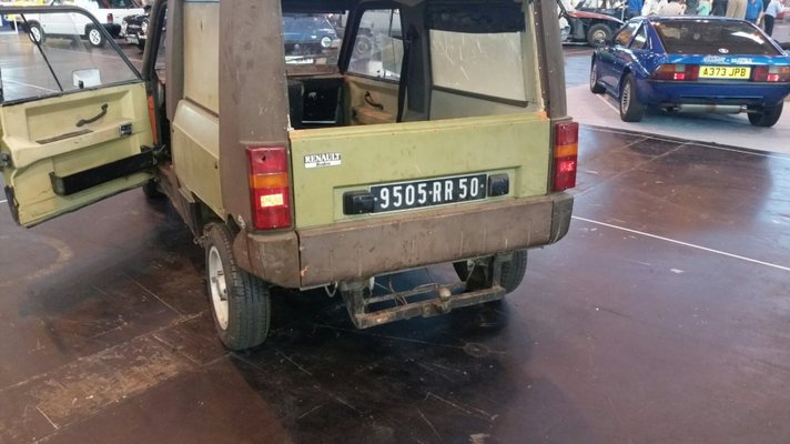

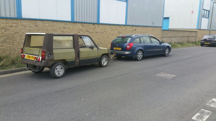

Having been nearly asleep last night when I wrote a few words to accompany the above pics checking today seems when I hit edit to remove duplicate pics I lost it all
Basically ended up volunteering to display rodeo at the nec show on renault owners club stand at the weekend I decided to a frame it as it is under 750kg and is legal as an unbraked trailer
I'd did have to fit new swivel for its journey though and nothing fell off in its travels

You are a brave chap well done with the display. I imagine rodeos are very rare. I don't really recall ever having seen one before. Very stylish!
And your chassis despite suffering the humility of being parked in a skip is really coming on and looking great. Are those Franzose pre fab repair panels?
