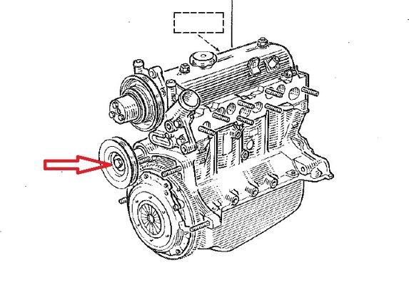

How easy is it to rotate the engine (to check points/dwell angle) without having to jack up the front wheels? Some books talk about applying a spanner to a nut on one of the pulleys at the front of the engine.

the spark plug nearest the front (cylinder #1?) is difficult to access (due to the alternator), so if I can get away with jacking up just one side, then that would be easiest I think (I'd not realised you only need jack up one side). (Plus I'm not sure if there is an accessible 'main crank bolt'?)

Cylinder no.1 is indeed on the front side. Jack the car up on one side, put it in second gear (like @Andrew4Renaults wrote) and turn on the jacked up wheel, it's possible due to the working of the differential inside the gearbox.
There is no "main crank bolt" at the front, but you can use the camshaft pully bolt and with the help of a fittable spanner you can turn the engine.
But turning the wheel is easier.
If you want to turn the engine from the camshaft bolt do take the spark plugs out please. At the distribution side you are turning a large sprocket that turns the small sprocket of the crankshaft. The extra force from compression inside the cilinders if you leave the spark plugs in, might damage the camshaft bolt or destroy the thread the bolt sits in.
Honestly I’d go for turning one of the wheels with the other on the ground and the gearbox in second gear.
I agree with @harbourseal, turning the camshaft bolt is risky but @jjad asked for a possibility so my last sentence was "turning the wheel is easier " and you should (could) go for the easiest :D
jacking the car up sounds easier than extra loading on timing chain and tensioner etc with possible damage risk

ABSOLUTELY! You need to keep the "working" side of the timing chain tight throughout this manoeuvre, or you'll not obtain an accurate setting. Mindful of other comments earlier in this thread I'd just say that removing the plugs reduces the resistance in turning the engine to almost nil, so I would think then turning the engine using the fan belt or a spanner on the dynamo pulley is easier than jacking a wheel and turning it. I would also contend it's more accurate!
