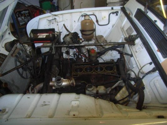

Exciting Gasket Pictures
HI,
Love R4s, what other car can you take the head off in half an hour?

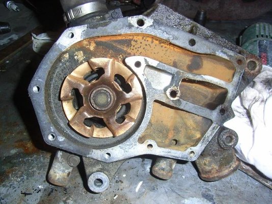

After wrestling the water pump off the head (2 seized bolts needed to be drilled), removing the studs etc. it was bare apart from the valves.
Decided to check out the urban myth of a dish washer as a parts cleaner. Secretly, after all the family were in bed I put the head and a few bits in.
After an hour an a half on max temp., the kitchen was (unsurprisingly) beginning to smell like the inside of a hot Renault 4 engine, so I abandoned proceedings worried that I would get caught and then divorced.
Opening the dishwasher revealed an immaculate head and bits. I then reset the dish washer to clean itself before breakfast.
This morning, smell gone, dishwasher clean. Looks like I got away with it. Shall not be trying it again.
I took the bare head (with valves) to my local friendly Mercedes garage (on a Sunday morning).

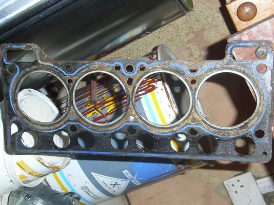

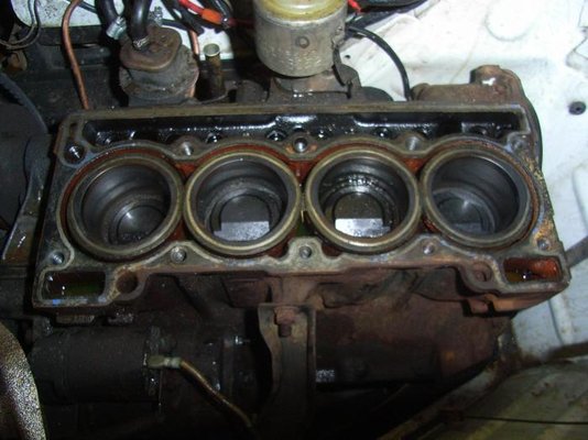

The engine looks A1, no bore wear, all very clean, no corrosion, backing up the low indicated mileage of the car.

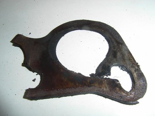

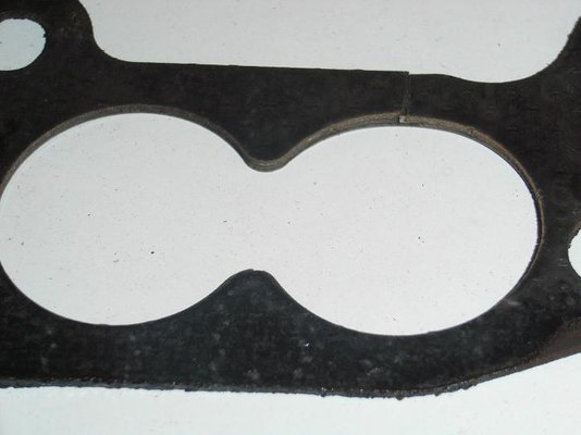

I have noticed a split in the inlet manifold gasket (NO. 2) and another in the exhaust (No. 4). This wont help.
Checked the recirculation valve, it is present and correct, rubber pipes not split.
Whipped out the ex. and inlet at my friends garage of suspect no. 2 cylinder, slight pitting in the exhaust seat, but not much. Not much carbon.
Sorry no pics of the clean head, it has gone to be fettled.
The head is off to a small race car workshop tomorrow for new seats to be cut and refacing so I know it is A1 when refitted. Might get them to take a bit off for fun (anyone got a R5 GTL carb + bits?).

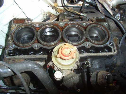

I'm sure your aware but thought I best say - careful not to turn the engine as you might damage the lower liner seals.
Turning the engine
Thanks, I wont be doing that.
James
explain please?
They are wet liners so they need to be bolted down when turning the engine with the head of. I would bolt them down anyway as when the block surfaces are cleaned up the last thing you need is to move anything.
Steve,
I am going to bolt them down. Good advice.

To hold down the liners use the head bolts and a lock nut and large washer on each. Before replacing the head run a tap down each thread hole and blow out and rubbish in the hole to ensure an accurate torque reading.
