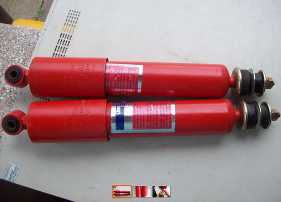

does anyone know shock absorber dimensions?

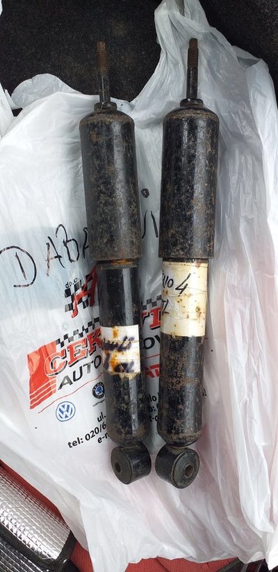

New old stock shock absorber.. good or bad?
front.. I got it for free..
If they are working easily up and down when you press them then could be good.
If not then they are no good any more.
tnx @petak , i didn't take them, a friend took them from store.. he says they work in both direction.

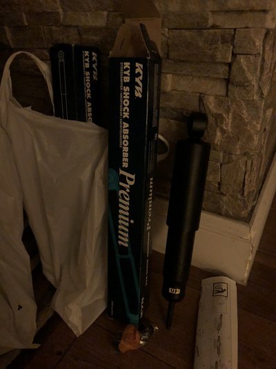

I'm letting you know...
I recently bought KYB rear shock absorbers... I shall fit the rear ones soon.
Has anyone else has a experience of the KYB brand shocks?
