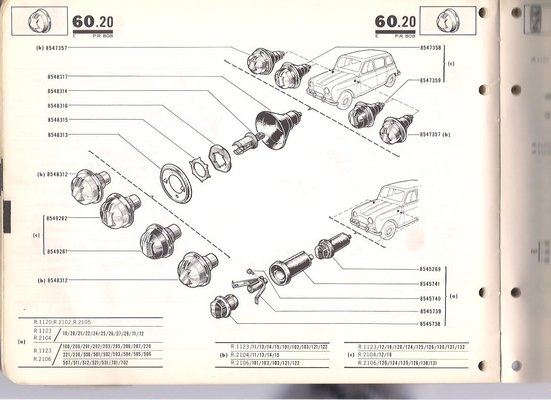

1624288159752.png"coat of arms" on orange-lens not EXACTLY like this :whistle: ,but hope you get what I'm on about.These side repaters has a coat of arms or "shield" on their lenses,theres an alu-rim around it with a grey rubber-seal that goes against fender. I can twist repeaters round and round so not screwed on to fender,but how is it stuck on there?
is it a push-in & expand kind of thingymajing or what?
-Inside of fender covered in an inch(!) thick sticky layer of rustproofing (which have saved the fenders amazingly well)
I'm plucking parts from a met.green -78/79mod. (No papers) All the panels/doors/boot/bonnet all rustfree so well worth to take it apart. Everything inside nice & tidy too.. -Reid
Does it help? It looks like the lens is being held from inside the wing by part 8548315 - may be a sheet metal nut.
Hi Angelos, you migt be on to something.looks like theres treads on the innermost part of the repeater,seems a bit flimsy to use a "sawbladed"
washer but i'll have another look as I really don't want to start digging into that sticky rust-proofing stuff..Never seen this thick a layer inmy life.
I finally found it out after scraping off a load of rustproofing inside fenders ,as on your pic. there's a "hollow" nut with a sawtooth-shaped washer inside it.
