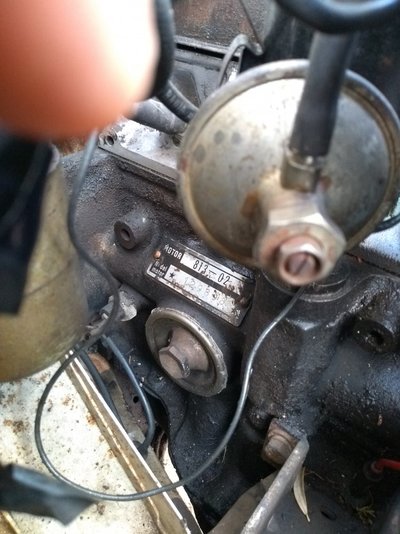

Unfortunately all I can see is the plate with :- MOTOR 813 - 02 AND NO- DEL MOTOR129898 .

Yep that sheds a light on the type of engine.
It is a Spanish build 852 cc Sierra engine.
34HP
5 main bearings
4 cilinders
It turns in the opposite direction as the bigger 956 cc and 1108 cc Sierra engines.
So if you want to do an engine swap for a bigger engine you need to change the gearbox to.
The same engine was used in some French R4’s for tax benefit.
