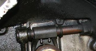

Hi, the stiff clutch might be caused by a seized clutch lever.
I came across a gearbox with the clutch lever completely seized up.
After a drenching in wd40 it’s loose now.
But it will probably seize again if I don’t take it apart and lubricate the bushes. And the rod that connects to the lever.
I forgot to take a foto but I found something online that looks similar
It’s the bushes in the bell house that caused the stiff clutch in my gearbox.
