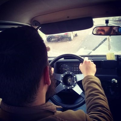

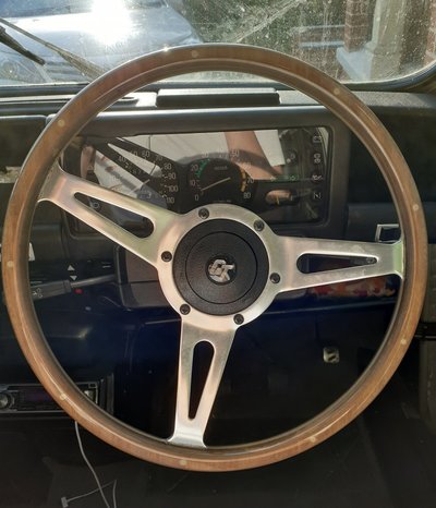

Hi Simon, you may remember this is the wheel on my car, it's a Mountney, 12 inch one. The boss I found on eBay for a R5. I just had to drill some extra holes to fit it as the boss had 9 holes, and the wheel 6.20200414_162755.jpg
Hi Simon, you may remember this is the wheel on my car, it's a Mountney, 12 inch one. The boss I found on eBay for a R5. I just had to drill some extra holes to fit it as the boss had 9 holes, and the wheel 6.View attachment 25878

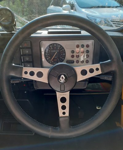

Here's mine:IMG_20200412_143915864_HDR~3.jpg
Hi Eccles60, large flat screwdriver as a lever. It can be stubborn, so don't be scared of it. Nice wheel, it should look good, and much smarter than the original.

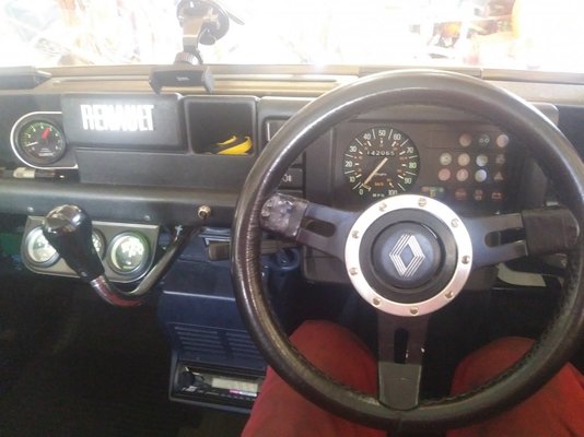

I've got this Moto-Lita I bought in Thenay in 2015.
Now I need to put a cover in the middle and refurbish the leather on the crown.

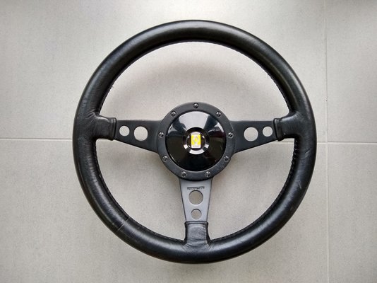

You can get a variety of wheels to fit a Mountney hub like this on on Mums car, as long as they have enough clearance to pass the controls. Or you can get a Springalex hub that can take Mountney wheels as well as their own.

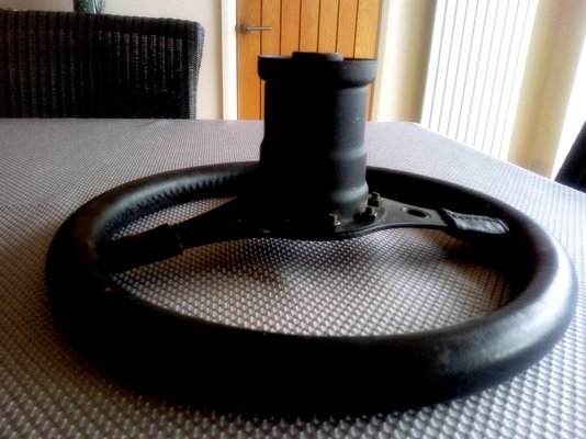

Or a Renault 5 Gordini wheel but they often have perished leather which can be costly ontop of the ridiculous asking prices. And the hubs are hard to find as well. We could not find a hub but found one that allegedly fit but needed a homemade adaptor to fit the wheel on.

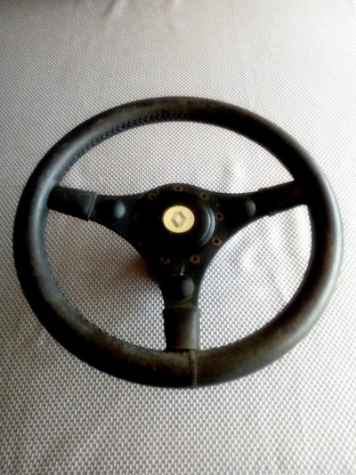

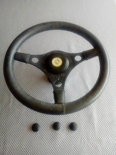

I've found the black leather steering wheel from my Renault 15TS that was transferred to my R16TX in the late 70's. It has the same spline/nut fixing as the R4, 14 inch (360mm), the hub is 4 inch (100mm) deep to clear the column stalks. The black alloy spokes have thumb spats with a single perforation on each spoke infilled with a rubber grommets. Anyone interested at £50 + p&p or collection from York?IMG_20200518_182258.jpgIMG_20200518_182258.jpgIMG_20200518_182258.jpgIMG_20200518_182258.jpgIMG_20200518_182211.jpg
