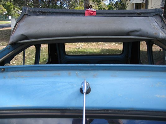

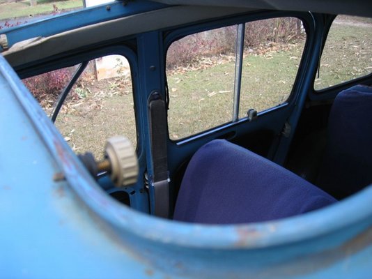

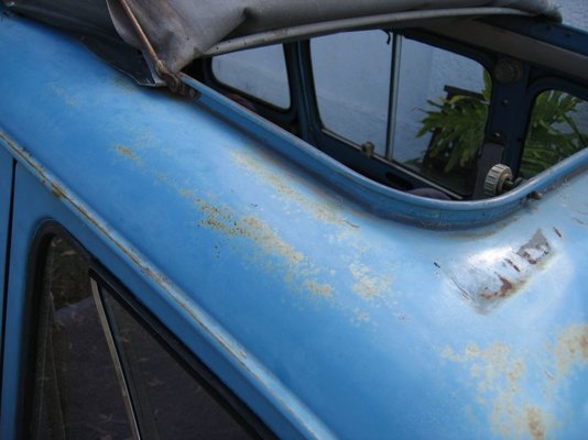

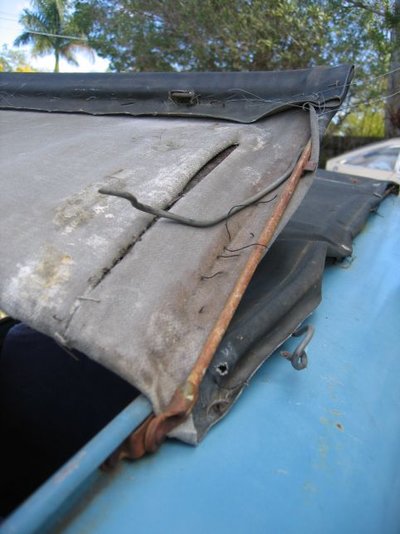

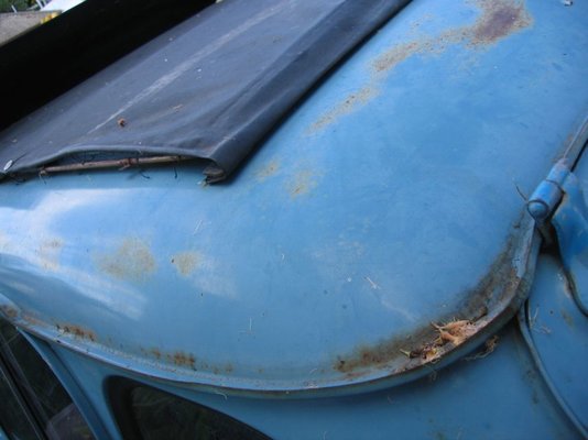

Thanks that would be good. I realise that there must be some strengthening as I have cut the roof out of an old body and it is really thin that metal,very little rigidity. Anyway measurement ,photos or drawing would be great

Sorry for the delay Richard on these pics of the sunroof. I've been busy as a brickie in Beirut.
The sunroof measures 85 x 132 (cms)
