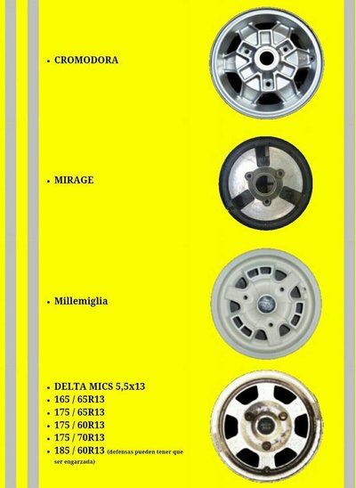

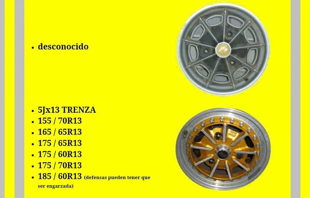

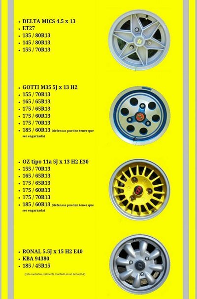

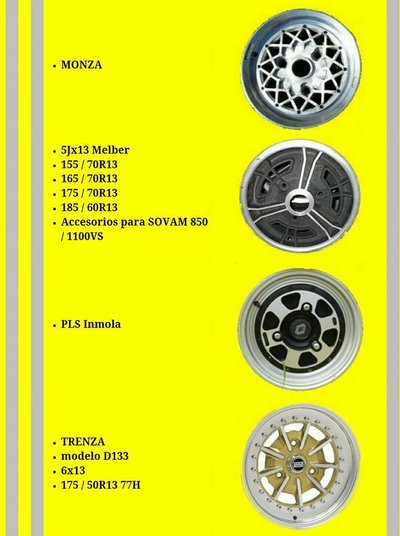

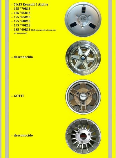

Various styles of wheels for Renault 4s

As a relative newcomer to Renault 4s, I am curious about what wheels were fitted, and can fit our cars. I have seen the occasional pictures of alloy wheels and pressed steel wheels, but I think it would be nice if an illustrated article on the wheels could be compiled and included in the Tech Tips section, so they would be all in one place. Me? I am far too inept with computers to even think of trying. What do you think?
I think there are some details on some of the various types of wheel fitted (some not available in the UK) in the fascinating book 'Album Renault 4' by Robert Sejourne. It's in French, and very hard to get hold of (ISBN: 2-85120-482-3).

Personally I prefer the standard drilled steel wheels as they suit the basic role of the R4, but I appreciate people putting the above images of all wheels which fit.

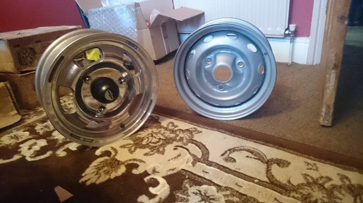

A quick question, I have two sets of rims. The right one is an standard GTL rim, but what is the left one? Any info on that? Thanks!:)
jurjenz.... left one was standard on earlier models. TL.
one with front drum brakes.
They wont fit front disc brake model as caliper is on the way.
They look much better to my and iam thinking how and what to modify so that they fit disc brake model as my GTL is
