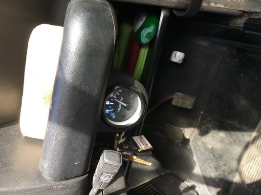

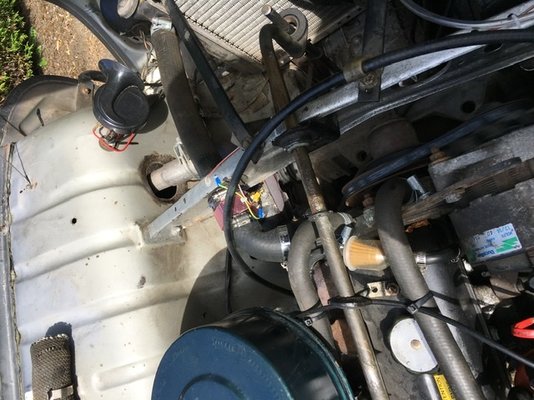

With a view to embarking on some long trips once we’re allowed out again I’ve been working on advice previously given on this forum to enhance the car’s dependability and fitted a water temperature gauge and a radiator thermostat bypass switch for when it gets really hot. All easily done despite not having a removable blank on the water pump to take the temperature sensor - so I used an inline adaptor on the top hose.
But a short test drive has resulted in the gauge hovering at the top end of the scale - not the reassurance I was expecting - and then dipping into the red as I let the engine idle to await the fan tripping on - which it didn’t before I chickened out and turned the engine off. I have witnessed it kicking in by itself previously. And all hoses under the bonnet were certainly hot - but the question is, how hot? Maybe it has always been this hot but without a temperature gauge to distract me it hasn’t appeared as a problem.
Should I believe the gauge (and maybe give the system a thorough flush) or are these gauges of variable quality? Or would it be worthwhile testing the sensor and gauge in a pot of water brought to the boil?

Side note, fitting a temperature gauge after the thermostat is not a good idea, if the thermostat stays partially or fully closed it's not going to warn you.
Good point, Angel, on sensor placement. But possibly not a good idea to move the thermostat down the hose towards the radiator (to make room for the sensor adapter) which was my first thought?

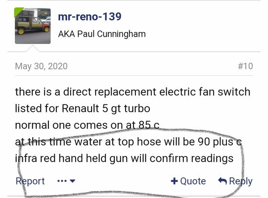

there is a direct replacement electric fan switch listed for Renault 5 gt turbo
normal one comes on at 85 c
at this time water at top hose will be 90 plus c
infra red hand held gun will confirm readings
