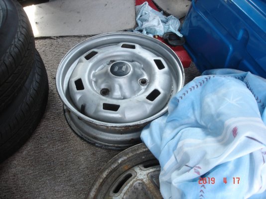

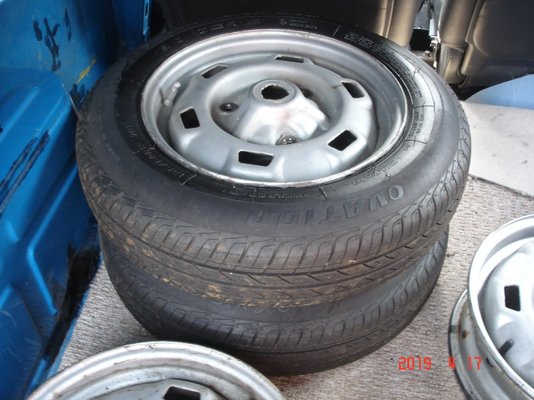

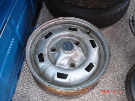

To R4 matters. My second F4 came with steel wheels which I have replaced with Speedline alloys.
I had removed tyres from 3 of the 5 wheels. 4 were of 1 pattern and the 'spare' was another. Checking wheel widths today 1 is 125mm wide and others 140mm. 2 with tyres still on are 140 it seems as they have a 9303 marking on them too. The 'spare' is 125mm width.
Can anyone clarify what I have please? Some pictures attached.

They are fitted with 155/70/13 tyres. I've kept them for a friend, as I use 165/65/13 on my 4.

regarding the wheels 2 types of these rims first had solid centres 74 to 77 designed for tube tyres
78 on had center Cap and take tubeless 145 ×13 was factory fit
now called 145 80 13
from memory widths were slightly different
