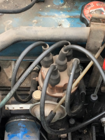

It's hard to be sure without seeing a photo of your car's distributor. I have a friend in Morocco with a similar car to yours (the oval plate number is just 5000 away from yours!). Looking at the photo below, his seems to be a Ducellier:

Hi Andy,
Thanks for your prompt and comprehensive reply. Unfortunately I don't have any photo's which show the distributor, only ones with the engine plates. I'm guessing that it will be a Ducellier but not 100% certain. I would like to replace the entire distributor but I think i'm right in saying that that is a 350.00GBP job.
