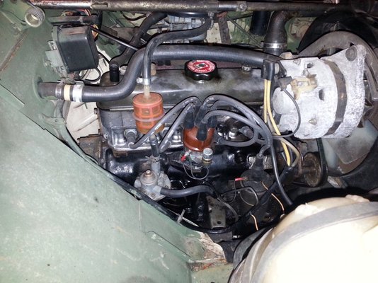

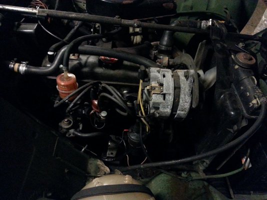

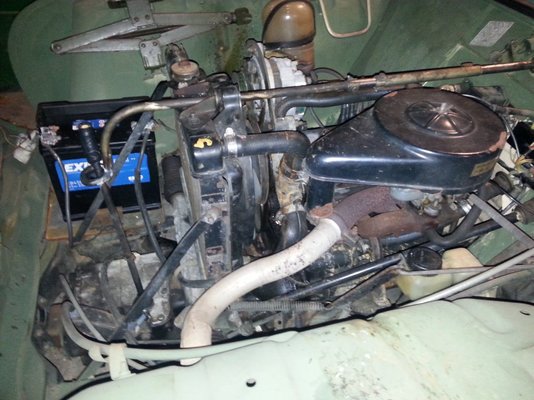

My water pump has packed up and my fuel pump is leaking from the gasket attaching it to the engine block.
It is a renault 4 tl 1980 1.1 engine .
Is it possible to know which replacement water pump and fuel pump i need from looking at the pics ?
I hope someone can help as my mechanic has given up looking for them

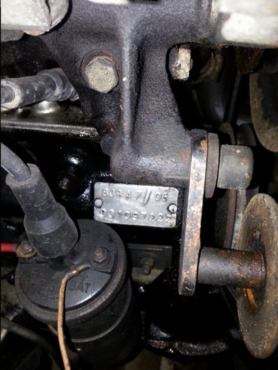

Hi Joe,
Looking at your picture I'd say you're not having a 1.1 engine. It's a 845cc ventoux/billancourt engine.
The gasket is probably leaking oil. This leaking gasket does not mean you have to replace the whole fuel pump. Just the gasket will suffice.
As for the waterpump you can get a new one from der Fransoze in Germany http://www.franzose.de/en/Renault/R4/Motorkuehlung/ANR82033/
Or try one of these they have a ref.nr for the manufacturer http://www.mister-auto.nl/fl/waterpomp/dolz-r121_g1260_a154R121.html
http://www.mister-auto.nl/fl/waterpomp/valeo-506341_g1260_a021506341.html
http://www.mister-auto.nl/fl/waterpomp/skf-vkpa-86200_g1260_a050VKPA!86200.html
Or try and contact R-Quatre in the Netherlands
he has the fuel pump gaskets in stock http://www.r-quatre.nl/index.php?it...n=article&group_id=20000085&aid=16383&lang=NL
Or even a new fuel pump
And he's also got the waterpump for you.
http://www.r-quatre.nl/index.php?it...n=article&group_id=20000330&aid=12086&lang=NL
Just give him a call as you know we dutchman all speak english.;-)
succes

finally had the time to check this beauty .
It is a
839 782cc Ventoux
Many thanks again
Joe
