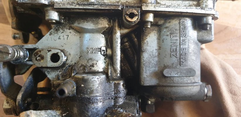

My 845cc BIB engine has a Zenith 32 IF 7 carb fitted to it.
Some research via la4ldeslyvie.fr suggests it should be a Zenith 28.
Can anyone confirm which carb is correct or could it be either fitted at the factory.
Any comments / references etc., appreciated.

The Renault 4 handbook 'Engine specifications' page shows that the Zenith 32IF7 was fitted to the 800 05 B1B engine (R1123 TL and R2106 F4).
