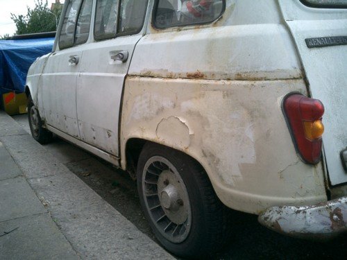

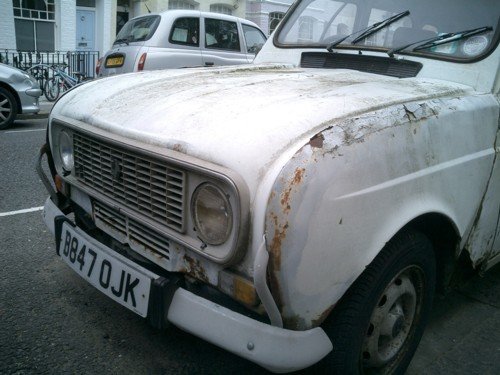

I am interested in knowing how your little restoration project is going?
Have you started yet and did you ever pic up all the spares from Surrey?
If you are underway, do put up some pics as they would be an inspiration to all!!

Oh, THAT! :)
Since I got her home, I have had to spend all my spare time doing "other things" and yet more "other things" of the small and pink variety might be on the horizon soon, so I haven't made any progress yet. I have however picked up two new front wings and some other spares, so all is set.
I haven't picked up the spares from Surrey yet, waiting for the previous owner to get back to me. (I'm also still waiting for the V5 if you're reading this Andy!!)
