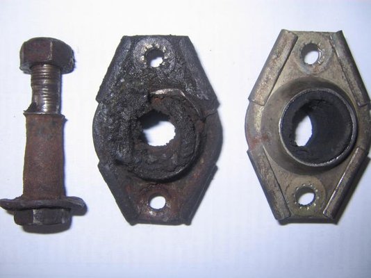

I'm still trying to get to the bottom of the negative camber problem I mentioned in a previous thread. I've tried everything I can think of; the van went straight through the MOT without any problems, although the tester said there was slight play in one of the tie-rod bushes. As you can see from the attached photo, both of them were in a pretty bad way(!) The newer one - from eBay - has only lasted a year before breaking up. I imagine the other one is the original; the bolt had been bodged, albeit very effectively, to compensate for the wear in the bush, but the hole in the offside tie-rod has become enlarged - I'm looking for a good replacement.

Those are the nastiest tie rod bushes I've seen. They would certainly cause bad tracking, tyre wear and weird suspension angles. Der Franzose have replacements for about 5 euro each, supposedly made in Europe (and silver rather in cadmium so possibly different from your replacement).

I've changed all the parts I thought might be responsible - I had to change the wheel bearings, so I replaced all the balljoints, the track rod ends and the nasty bushes in the photo. The only part I still need to change is the offside tie-rod; the hole at the bush end is slightly too big, so I think there could be a tiny bit of play there. Will see how things go, and then have the tracking checked.

What puzzled me is why your tie rod bushes are so badly worn, and even worse, why the new one lasted only so little. It seems that they are unduly stressed (bent wishbone? incorrectly adjusted tie rod? worn out lower wishbone bush?). When you loosen both bolts that hold the tie-rod, can they be removed and refitted easily, or do they need levering and hammering?

As far as the tie-rods/suspension bushes are concerned, yes, I had to do a little levering to get the bush bolts out, but nothing too drastic. Has anyone else had problems with the cheap bushes breaking up?

About the tie-rod bushes. I have always been buying cadmium-plated ones, not silver. Definitely not genuine Renault, but never had any problems with premature wear. The only problem I can recall was about 6 months ago, when I got a pair that looked of different design...thicker sheet metal, slightly different shape, and soething like plastic bush (not rubber). They didn't fit in the chassis and I returned them back.
A little leverage on the holes, as you describe, is normal.
