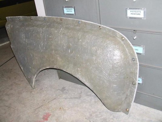

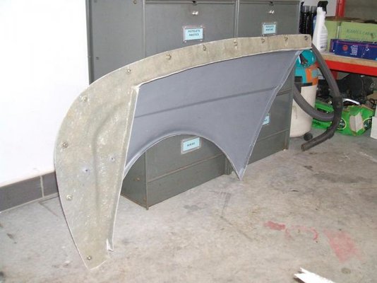

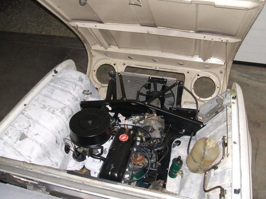

as you can see, I started the restoration of my 87 GTL 2 years ago; to prevent the rust, I decided to make the inner wings, and the front wings in fiberglass, you can see that in my thread here:
http://www.renault4.co.uk/forum/showthread.php?t=3140
But today I have a problem: the genuine bolts of the wings are shorter to fit correctly with my inner and front wings, due to the thickness of the fiberglass compared to the steel parts...
These bolts are 6.35 mm diameter (1/4"), 10 mm head, about 16 mm long, and they have, as you certainly know, a special pitch... In France, it's absolutly impossible to find what I need, in Great Britain, does exist the same bolts but longer than the old ones ? I would need about 25 mm long.
If anybody can help me... thanks you

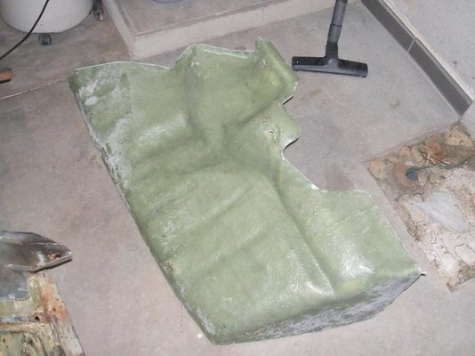

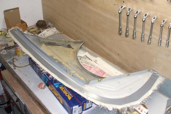

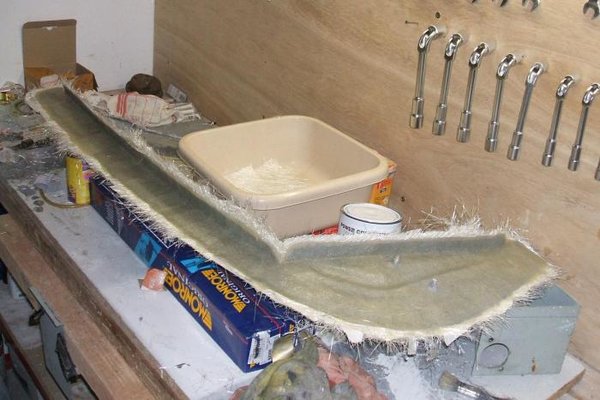

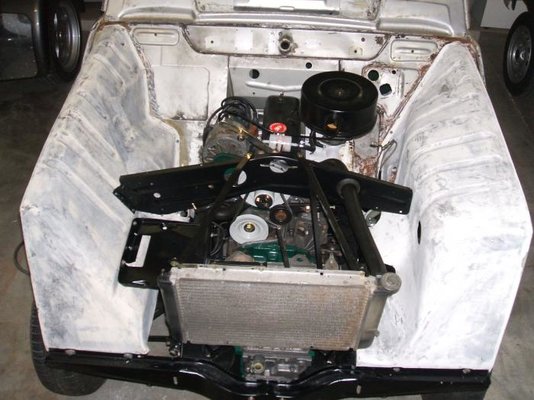

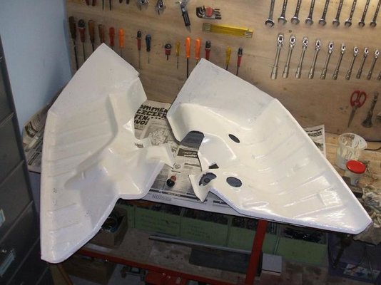

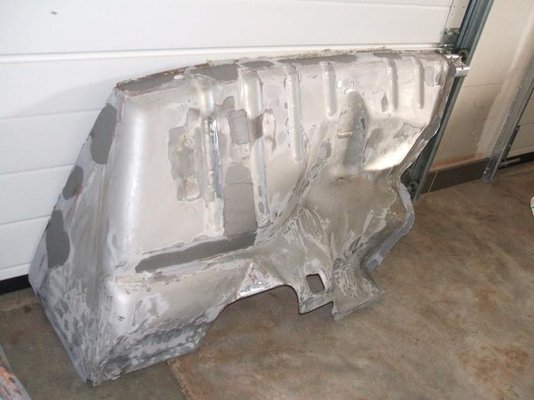

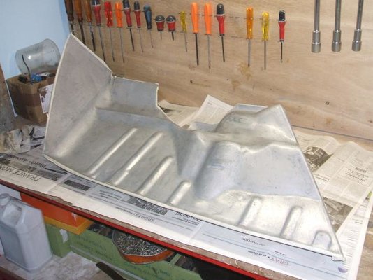

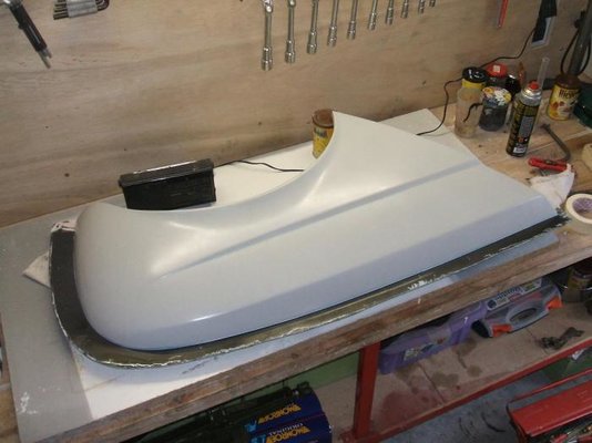

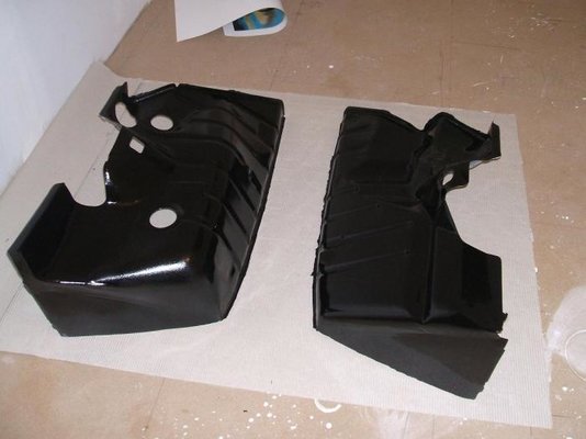

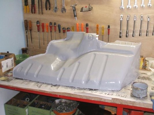

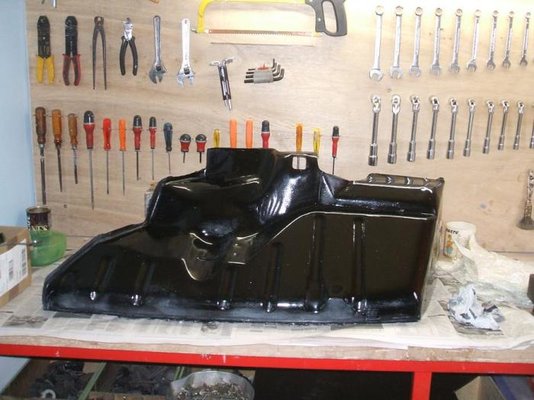

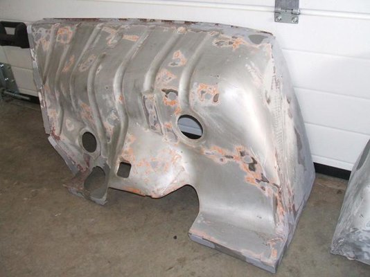

Even the parts are 3/4 mm thickness, they fit without any problem on the car, and between themselves. My inner wings were also totally rusted and impossible to repair, so I filled them the best I can before making the moulds around them:
