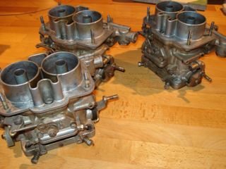

Carbs but no manifold
Dave, I've got a nice set of carbs for you but no manifold , perhaps someone could knock something up !
I'm sure you'd get 40bhp from these ......

What are those cheeky little chaps from? I'm sure a plate could be made to go twixt manifold and carb, vac advance dizzy, '76 cam, light head skim..............
