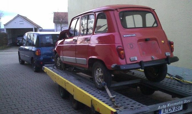

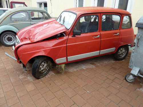

It looks like things are moving forward with the restoration of my '78 GTL. I acquired a car that has been through an accident and will use its body to get my original car on the road again while the original body will be restored.
I was searching the forum for "remove body" and had to smile for the implications ... :D
But the boots are already empty. Now ... could somebody please give me a walkthrough for a swap of body shells between two cars ... what are the minimal parts that have to be removed before the body shell can be lifted from the chassis.
Pictures to follow.

Hi Andrew, thanks for the rundown.
Lifting should not be a problem as the procedure will be carried out in a garage with a lift running along the ceiling.
Now I got this poor baby for 350€ and it'll
a) get my car on the road again while
b) providing enough time to have the original (pre '83) body restored and
c) yielding loads of spare parts that I had already considered buying.
It'll be interesting though how the chassis turns out rust-wise and distortion wise once the shell is off. The previous owner was a 88 year old woman who slid into a ditch with the car during the icy spell a few weeks back - the travel was stopped by a bush ...
