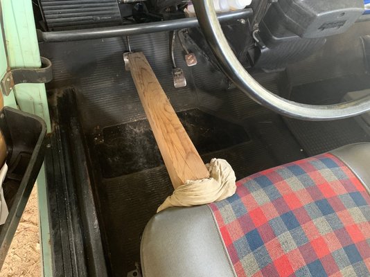

2. Make a stick that fits between the clutch pedal and the seat so the pedal is pressed down. This causes the clutch to continuously disengage while the pedal is pressed, you can leave it for a few days it might come loose.

I've put a piece of wood between the clutch and seat as you suggested and will leave it like that for a few days. Lets hope!

Hi mojobaby-Hope you get her going again soon.. Re your start-up & running 10mins.. I am always trying to let Roffen run for longer than this (atleast to get the temp all up to working temp.Then I take off the oilfiller-cap to let the wapor out. Back on again when only luke warm. Oil needs 90-100 C. to separate water/wapor instead of accumulating -Just a Tip! Re. your interiour-picture.. -When did you get a wooden leg ?

So glad that I took your advice Joop, your suggestion worked perfectly:clapping:
That piece of wood has been there since Friday and this morning I put her in gear, depressed the clutch and started the engine and no jumping forward.
So thanks very much Joop, you've saved me a months work and a new clutch:laughing:
