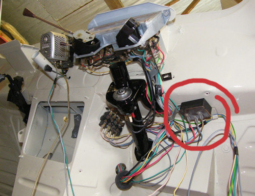

Would be inclined to disconnect the wires from the flasher unit (the one circled in the picture) to see if that makes everything else work.

1)I have a diagram of the the wiring and I will post a picture of the regulator, plus another one that I have as a spare however I don't know which wires go where and if the two regulators are compatible or not.
took the wires off the flasher unit as suggest but to no avail still the same out come.
