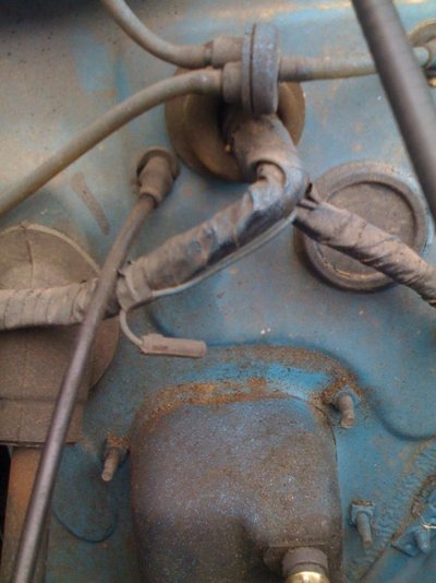

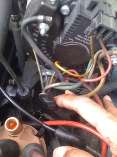

Here are two photos, the first of the alternator wiring—among the bundle of wires going into the larger tube is the yellow one on the left, which is attached to the same terminal as the wire grounded to the wing. The second photo showing the bundle passing through the firewall to the dashboard beyond. Is is likely that the problem is indeed a wire connected to the alternator, but where it connects to the dashboard?

Well, I think I know when I'm beat. After looking at every connection under the hood leading from the alternator to ground (except the one which counts, probably) and digging around behind the dashboard looking for yellow wires, I'm going to take the car into the garage and let the repairman take a look at it. You can't win them all, but there's still enough left to keep me busy. In fact, I have another question but that's for another thread...

The little yellow wire is the charging warning lamp wire (goes to the dashboard). Check that it actually does this (even if the wire there isn't yellow!)
