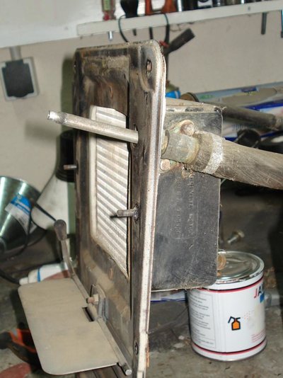

Photos

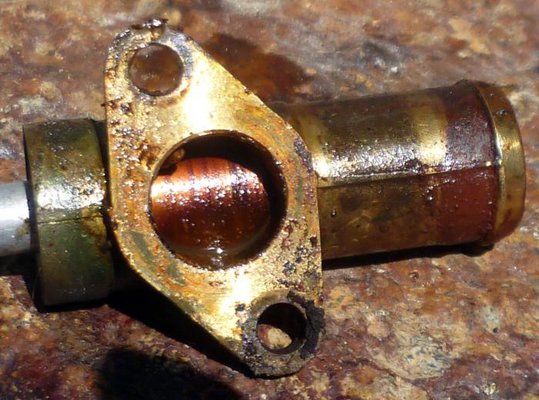

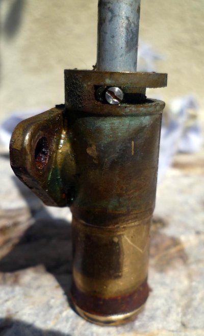

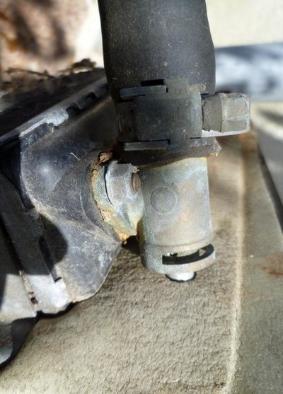

Having been inspired by Angel to look at the valve I took one to pieces this evening and took photos.
The only problem I had was the grub screw which was seized and so I had to drill it out (from the opposite side to the screw-head). A simple self tapper should suffice when re-assembling.

Simon, I'm not saying you've got too much time on your hands but...
Still waiting on that '64, will give you a bell when I hear
Thanks for posting the photos. Always interesting to see :)
Yes the photos - just reminded me that I have a new matrix, valve and heater hoses here - must try and locate them in my shed!

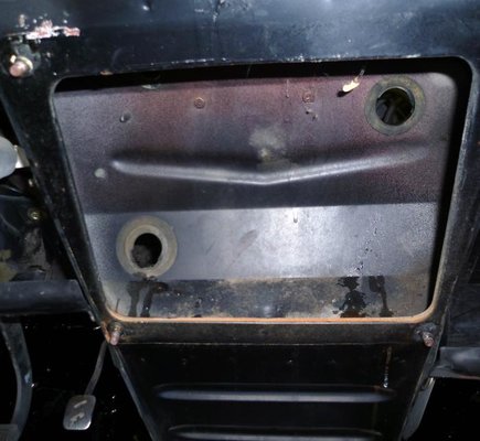

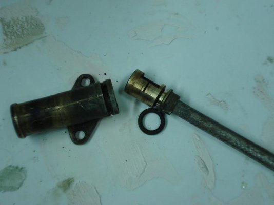

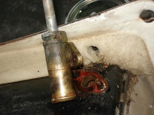

Well that all went smoothly enough thanks to the advice above.The offer of exchangeing spare valves against drinks will have to wait until another time - I'm sure it will arise soon. And refreshing to work on a Quatrelle where one can drop loose tools under the bonnet and for the most part the drop straight through to the floor unlike the DS where they lodge, inaccessible, invisible and irretrievable until the next engine out.
Left the valve itself soaking in WD over lunch and siest-obligatoire amd with the lightest of persuasions it all eased up and started moving again. Someone has obviously worked in this area before as the heater matrix was very clean for a 37 year old car and the small scre that hold the valve together had already had it's slot marmalised by someone.
Just waiting for the glue to dry on new foam strips where the heater ducting nuzzles up against the dashboard vents and I'll be able to give it a whirl on the morrow.
A couple of blurry snaps attached.
